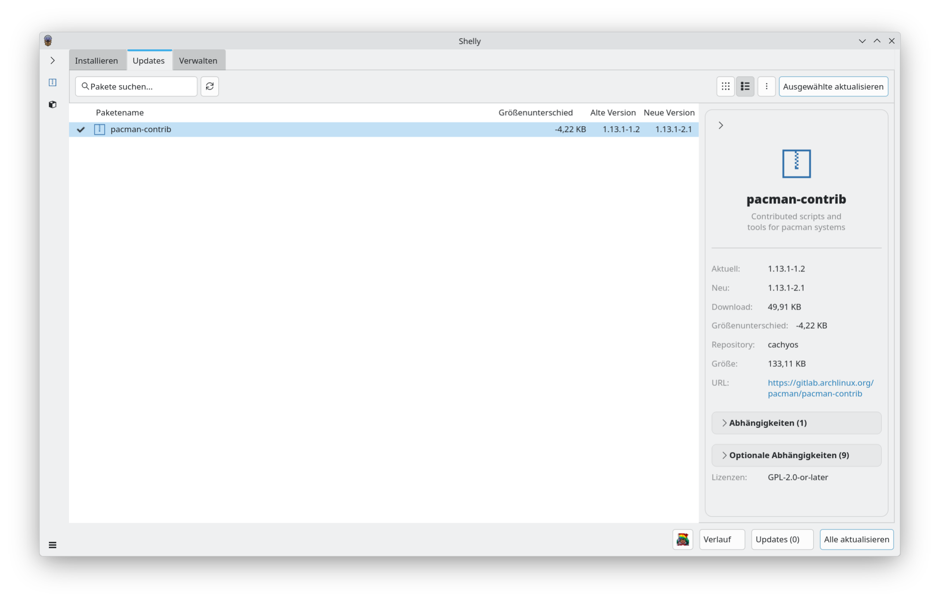

Back to the topic of Shelly: When I had Shelly check for updates a little while ago just for the sake of it, it indicated that the pacman-contrib package needed updating. A cross-check using sudo pacman -Syu revealed that NO updates were available. I went ahead and updated the package in Shelly anyway, since I had explicitly installed it during the initial setup. Strange, where do these discrepancies come from?

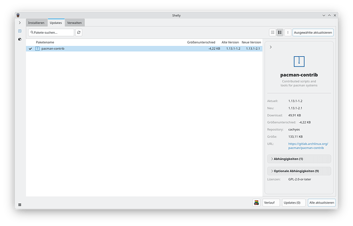

And just now, another update is being offered to me in Shelly: from pacman-contrib 1.13.1-1.2 to pacman-contrib 1.13.1-2.1
Does Shelly report from which repo these updates are coming from?
sadly not …
moment, on the right side: Repository: cachy
yes, I have an i5-8400
yes, it does
