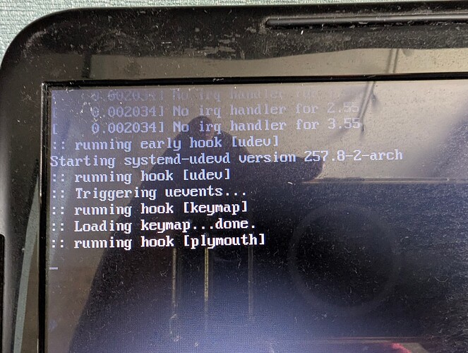

Hello, for the sake of interest I decided to put cachyos on my old laptop pavilion g6 2137sr.
Inside him Amd a10-4600m and amd radeon 7660g.
After installation and first launch of this system, the OS loading will hang at the stage running hooks [Plymouth]. What to do?
p.s: I updated the system via ttc with the command sudo pacman -Syu, but it did not help.
I’m curious though if it’s not your GPU hanging on the animation.
Have you by chance tried to add this to your grub, if your using grub?
plymouth.enable=0 disablehooks=plymouth
ie:
GRUB_CMDLINE_LINUX="plymouth.enable=0 disablehooks=plymouth"
If you do make this change don’t forget to update grub.
sudo grub-mkconfig -o /boot/grub/grub.cfg

I entered this, but when creating a configuration it tells me that such commands were not found:(
I did this but now instead of loading it hangs at the [OK] Reached target Graphical Interface, what to do with this?
It means the instigator of the problem is not Plymouth boot splash.
You could maybe use TTY or runlevel 3 to get further in the boot but without GFX at all.
If you cannot gain access with the existing/internal system then you can use a live ISO and chroot into it.
