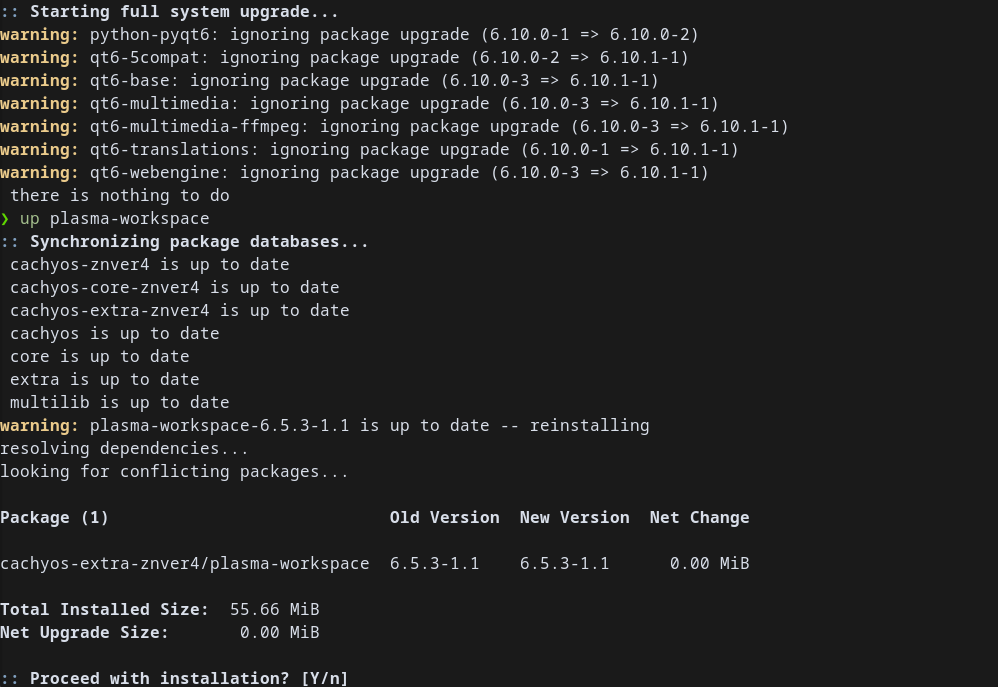

Err .. not so much? ..
That ‘dependency cycle’ really was simply one package being installed before the other though it expects the other way around. Both get installed. It is only a notice.
As per the thread issue - You just managed to hit a partial upgrade scenario.
As shown by myself and other commenters above .. an extra 30 minutes was apparently the difference here. You upgraded parts of QT but not the parts of Plasma (etc) that rely on it.
Try again with all of them and I am 99.99% it will be fine.

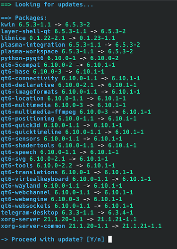

This is my current pending updates, and before checking to take this screenshot, the plama-integration & plasma-workspace were not present. Could this have happened to many of us ? That the plasma updates were late compared to the QT6 ones ?
i don’t see 6.5.3-2 yet (i just downgrading all the qt6 related earlier)
I can confirm its solved now, OS update without further issues.
Can confirm also, the plasma update was needed.
Solved, updated without problems too
