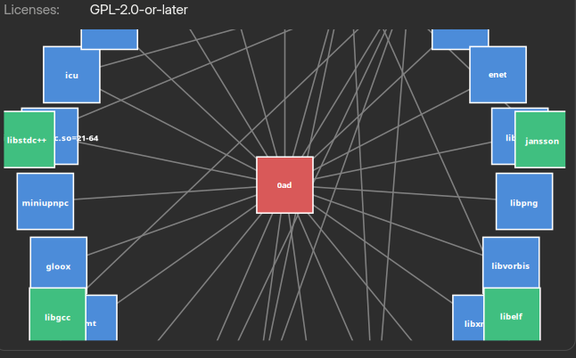

And now we’re faced with a confusing and noisy non-interactive graphic, which appears completely useless noise to the interface as it comes right underneath an actual list of dependencies…
But most interestingly, typing a single character in the Search window now causes it to crash out of existence.
So my stance remains - terminal still rules the roost here, and Octopi is the most reliable GUI option, though it won’t include snaps or flatpaks.

That was my reaction like -woah, new interface then… WTF is that really complicated graphic? then I realised that it was a kind of map of the dependencies of the initially selected ‘0ad’ app and also completely non-interactive.

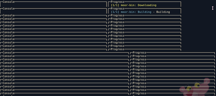

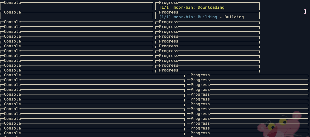

 ERROR: Package 'moor-bin' not found in any   ││ Waiting...                   │
│ sync database.
cli seems to suck, sorry.
Later it did work, but the output is just garbled.
What’s wrong with clear text outputs?
Are you on basic bash?
I don’t understand what ‘basic bash’ means, but I use fish, zsh and bash.
Strangely, when finally succeeding to install moor-bin - it completely skips the package build review… that’s pretty concerning as this project is supposedly beyond 1.0 and should have such basic features and safeguards in place.
