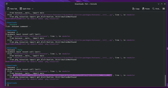

Recently installed cachyos along side my bazzite install. I was looking to transfer my bazzite plasma desktop over to cachyos using konsave. After installing I receive the following error. Both OS are installed on the same drive.

I actually found the solution to the issue.
It appears the setup tools for konsave didn’t get installed, when I initially installed konsave.
Entering - pipx inject konsave setuptools
Forced it to install the setup tools and konsave worked perfectly fine afterwards.
