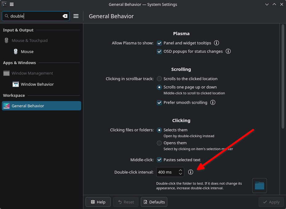

Are you looking for this?
Just tried it, same issue, also tried on Windows and had no issues once again
