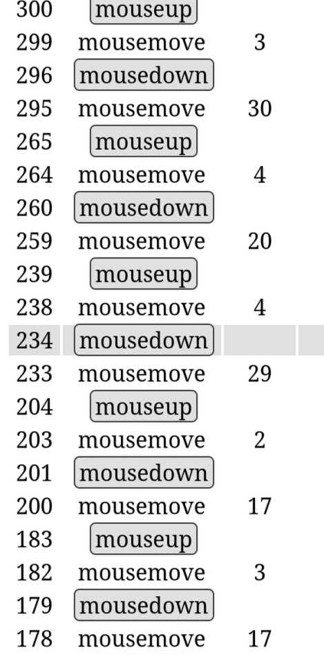

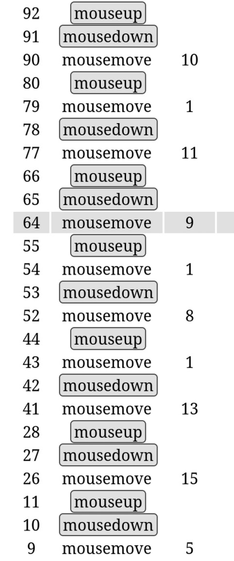

i don’t think it as to do only with mouse input i tested my movement with Mouse Event Viewer and im fairly regular in my mouse click and the dragging distance yet it happen about 3 time out of 10. i also noticed it seems to happen in cylce. to me it will work as intented then drag out 3 time in a row then back to normal. i would appreciate if you guys could try to

That is kind of crazy. Having just turned up everything I can in both KDE Plasma settings and on my mouse itself, I do not get any movements at all when clicking, even with mouse acceleration enabled. The max when accidentally bumping my mouse was one to three pixels.

you made me realize i can turn down my dpi. im now moving between 0 and 1 pixel between mouse down and mouse up and it still drag out the tab (also still intermittent).
i tried enabling mouse acceleration (i disabled it when i installed because it give me bad accuracy) and somehow it reduced the frequency of tab dragging
