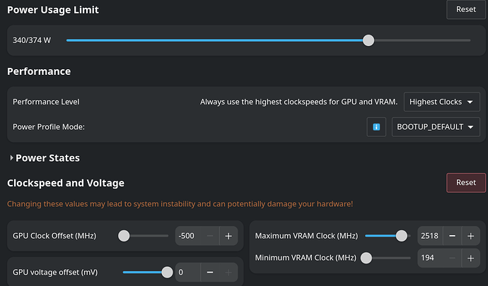

can i see your LACT config ? undervolting etc (if you use it to tame the incorrect clock speed report with auto overclock mode, atleast on my end)

This is my LACT config. I do not have overclocking enabled.

tldr: try change your performance level in lact to highest clocks too, and set -500 offset for gpu clock for safety purpose so it won’t breach your stock clock

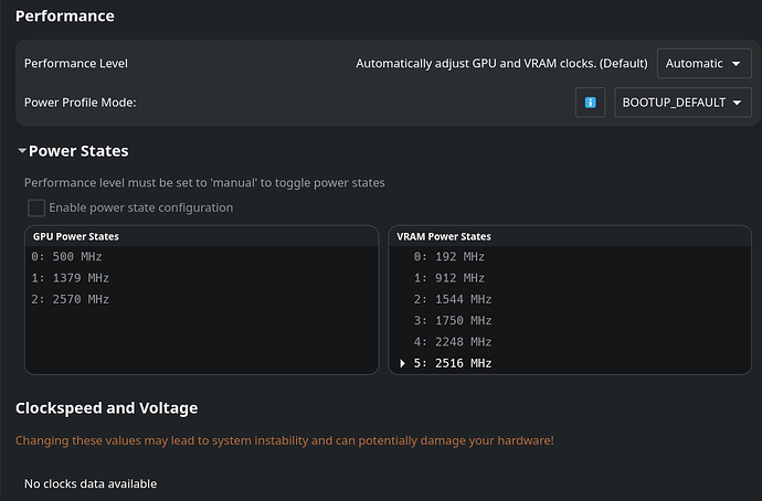

i want to see the bottome ones, also performance level don’t set to automatic, set to highest clock for safety purpose (to make the “STOCK” clock as the highest)
that’s the problem for my end as well, if i use automatice performance level, my clock speed easily reach 3.2ghz LMAO and yes it will crash my desktop
so what i did in my previous post (2nd post i think)
i set the performance to highest clock
and just in case, use -500 offset, raise a bit of my vram clock (you can ignore this) and undervolting (gpu voltage)
if you set performance level to manual, it will apply the clockspeed settings in below section (and always go -500 offset for starter) so your gpu clock is near the stock level, then you can raise it bit by bit if you want to OC your gpu clock
also good luck on this attempt, if it’s the same problem like mine (gpu clock is too high, due automatic boost), then what i share to you should fix your issue

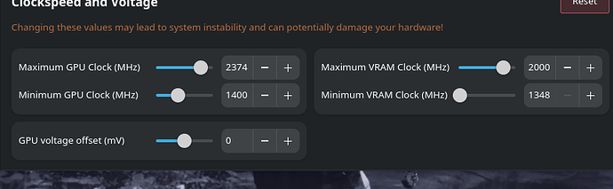

The settings at the bottom of LACT are as follows.
After enabling the overclocking settings, the defaults are as follows:
Here are the settings after I modified them. I only adjusted the frequency, because when I used AMD Software to lower the GPU voltage on the Windows platform, it often caused the settings to revert to their defaults.Maybe I will try slowly lowering the voltage later. Based on my experience, this should work, because when I played games that didn’t fully utilize the graphics card a few days ago, I didn’t encounter this issue.

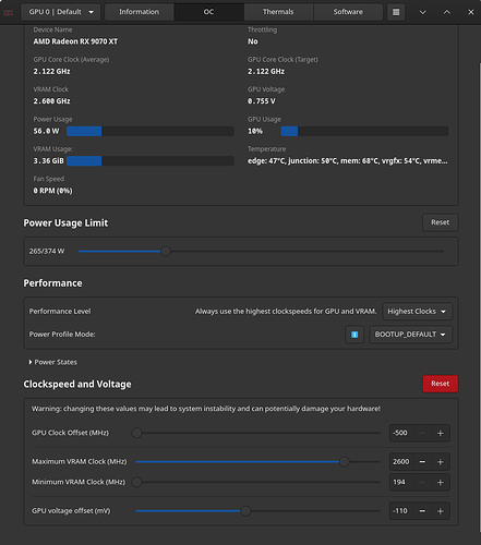

my value is stable around -80 ~ -90

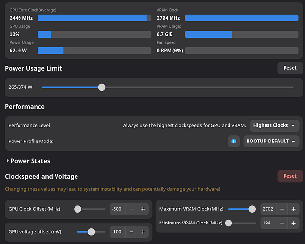

my gaming profile for my lact should be like this
