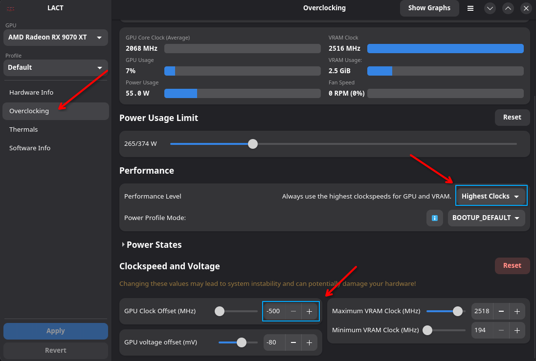

idk if this help, but maybe try change the automatic to highest for now ?
in case LACT detecting wrong speed frequency like RDNA4
if you use this option and it’s working, another advice is
create another profile, with highest clock performance mode, for those game only / affected app, and keep the default profile to automatic (since i think, it’s rare to get clock higher if it’s not 3D application)

@Biscuits - you are offering the same unsafe advice I just warned you about - unless you also have a 5600 card, and you know it is not affected?

but you are still offering the same bad advice after being told it is not safe / good / recommended / appropriate for every card. You are potentially crippling other people’s GPUs by suggesting Highest.
Adding “idk” does not change anything - it is bad general advice.

Ah, I see. You have failed to understand what I explained. Let me try again:
On some cards, setting Highest performance in LACT causes the card to be limited to highest BASE clock, thereby not allowing it to reach BOOST clock. Therefore, you are CRIPPLING the performance of the GPU.
