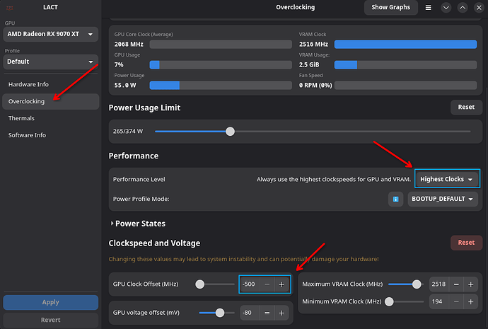

install LACT and enable overclocking (we didn’t overclocking, instead downclocking LMAO)
since you’ve using 9070XT, like mine, the easist way is
  1. change the performance level into “Highest Clocks”, the mostly culprit was “Automatic”
  2. and for the final ones (in case still happens), change GPU Clock Offset to -500
the rest is up to you, if you want to undervolt or not
Another note, to avoid forcing your GPU always use the highest clock, instead of overwriting the default profile, better create another profile for this, so you can still use automatic mode for your other apps, and switch the profile to highest one if you want to prevent the artifact or crash when running 3D apps
