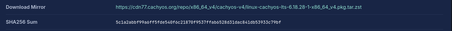

I have downloaded the packages manually from https://packages.cachyos.org, and checked the sha256 sums.
The sha256 sums do not match:
~ >>> curl -JO https://cdn77.cachyos.org/repo/x86_64_v4/cachyos-v4/linux-cachyos-lts-6.18.28-1-x86_64_v4.pkg.tar.zst
~ >>> sha256sum linux-cachyos-lts-6.18.28-1-x86_64_v4.pkg.tar.zst
7a98439998d98d0c5bb61879e36110f5228eddcee722c6e0640a26580e2cdc06  linux-cachyos-lts-6.18.28-1-x86_64_v4.pkg.tar.zst
This is specific to the v4 repo, which would explain why it only affects some users.
The same error apparently occurs during instalation from iso, so probably not a config issue.
