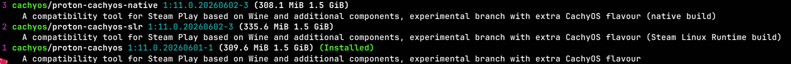

Yeah the page says “In the CachyOS repositories you can find two different flavors” bla bla. Ths has three. Not sure of the dfference here. proton-cachyos proton-cachyos-natve and proton-cachyos-slr are all separate pac ages.
So, that basically did the same (+1.5GB with -native and -slr being installed:
Full output of sudo pacman -Syu proton-cachyos-slr
 cachyos-znver4 is up to date
 cachyos-core-znver4 is up to date
 cachyos-extra-znver4                       4.3 MiB  1405 KiB/s 00:03 [---------------------------------------] 100%
 cachyos                                  511.3 KiB   926 KiB/s 00:01 [---------------------------------------] 100%
 core                                     126.6 KiB   174 KiB/s 00:01 [---------------------------------------] 100%
 extra                                      8.3 MiB  1585 KiB/s 00:05 [---------------------------------------] 100%
 multilib is up to date
:: Starting full system upgrade...
:: Replace proton-cachyos with cachyos/proton-cachyos-native? [Y/n] y
:: Replace proton-cachyos with cachyos/proton-cachyos-slr? [Y/n] y

resulting in this:
pacman -Qi proton-cachyos proton-cachyos-slr proton-cachyos-native

So I guess I’ll grudgingly do pacman -Rns proton-cachyos-native, but I find that behavior a bit odd, tbh. Why recommend *-slr on the Wiki, but install both when replacing proton-cachyos? For completeness’ sake? I’d rather save those MB :slight_smile:
For the most part the devs may compose a PKGBUILD a certain way so that a resulting package has certain qualities or dependencies but not something like it sounds you are describing.
I am pretty sure no one anywhere decided “let them have multiple protons on purpose, while leaving at least one of them an orphan - this is surely the correct thing to deliver”.
Instead I think it just has to do with how the dependencies are being met.
Though I could not tell you exactly why both (seem to) need to replace it.
It may have something to do with the double “Provides” - with one technically providing “proton-cachyos” and the other “proton” .. until the exchange is finalized and with the totality of things finally recognizing that deps are met with just one. Which still seems like a bug of some kind.
Probably not, but
It sure does. I did pacman -Rns proton-cachyos-native and it wanted to uninstall all of these, too:

I got scared, backed out and did pacman -R proton-cachyos-native instead, which left me with all of these packages as orphans.
So I uninstalled them and all looks fine now, but I really think this is a weird behavior on Cachy’s part.
I mean if we simplify it back its just the one double-package thing, which ..
Now that I look at it again … this does appear like you could have responded n to one of these?
Could’ve, should’ve. Never forget: I am still a total newbie, hoping that Cachy cares for me :smile: I realize that I should probably have said NO to the first and YES to the second, but as there was no announcement on that, I felt kinda lost… and I bet I’m not alone in this :wink:
According to
proton-cachyos does not exist anymore and has been replaced by -native. They pretty much renamed it
Additionally, proton-cachyos has been renamed to proton-cachyos-native.
