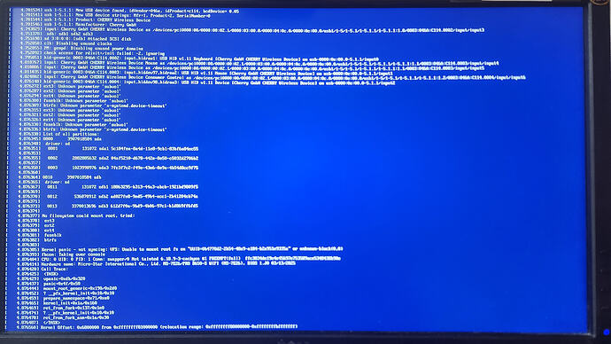

I will now boot into the 6.18.x kernel and shoot a photo of the kernel panic. Then I’ll boot into the LTS kernel and provide journalctl -b -1. I guess this is the best I can do, right?
Here is the photo:
My journalctl --list-boots does not show that boot process at all! Should have been at around 11:19

Edit: the photo talks about “Unable to mount root FS”, right? If that helps: this is a NVME drive. The other drives you see in the photo are HDDs with just data, no operating system. I have no idea where the “Unable to mount root FS” comes from, because when I boot the LTS kernel, it boots from exactly that drive.

Edit: just checked your post. Based on the kernel panic error you’re getting, it might be worth a try to change boot manager, since it’s a FS mounting issue.

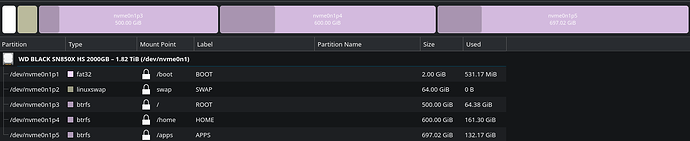

  3. I wanted to switch to Limine, but I realized that I would have to resize my /boot partition from 2GB to at least 4GB (I’d make that 8GB), but I am scared to do that.
This is my current partition setup:
As you can see, it’s a mixture of fat32 (/boot) and btrfs. In order to resize /boot, I will have to shrink /home, then move swap, / and /home to the right on order to be able to grow /boot.
Is it safe to resize / move btrfs partitions?
I am really scared here :fearful:
If you need the safest option, don’t move Btrfs partition:
Just shrink your swap partition by 8 or 16 GiB (especially if you are using heavy Nvidia modules for early boot).

Thanks for the tutorial. So you are saying I am not resizing the existing boot partition but creating a new one? And I will just keep the old one which will then be kind of obsolete?
But before I can do all the things you said, I guess I need to install limine with pacman -S limine, right?
If you suspect a boot manager issue, maybe check that rEFI’s config didn’t get overwritten inadvertently (not that that is likely for a package that hasn’t seen an update in 2 years). There’s a specific config needed to recognize arch kernel/initramfs pairs properly, for example.
The existing boot partition is marked as old like a backup. You can copy files back from it later if needed. That is the safest option if you don’t want to take any risks.
limine is already included as a dependency in limine-mkinitcpio-hook, so pacman will install it automatically.
