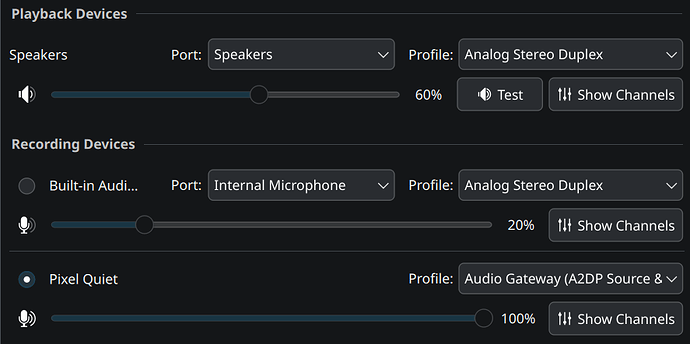

Wireless Bose bluetooth headphones only appearing as audio gateway and automatically switching back if I change it

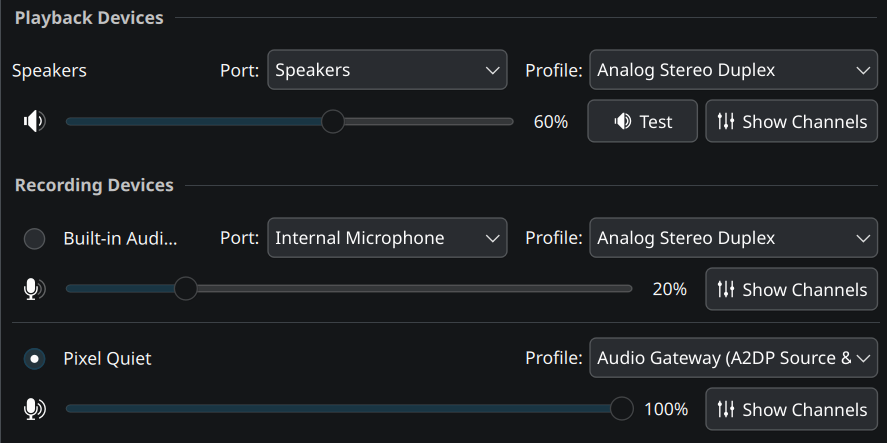

My Bose bluetooth headhpones were working with Cachy not too long ago but recently (within the past month-ish) they connect as an Audio Gateway device instead of headphones. If I switch the gateway device, I only have two low quality, mono connections available. At that point, the headphones will appear under Speakers but only for about a minute before it automatically switches back to audio gateway.
I’ve done it with music playing and while just sitting while connected. Sometimes it takes a few minutes to switch, sometimes it happens just a few seconds after I change it from Audio Gateway to something else.
The headphones work fine otherwise. Meaning if i connect them to my phone or something, they work perfectly fine with the noise cancellation.

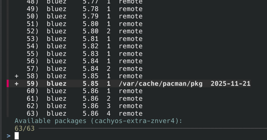

You look to be suffering from this issue that has been broken (for months) since bluez 5.86
Downgrading to bluez 5.85 will fix the issue.
Like a charm!
Thanks! I didn’t have downgrade but an easy pacman install got that remedied. Downgraded to 5.85, the script added it to my ignore file too which was nice. Didn’t even need to repair my headphones, just reconnected and they instantly popped up as a High Fidelity AAC device!
