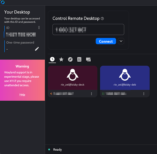

can you open rustdesk on you niri, check if you got the same Warning msg like me Wayland support xxxx (on previous screenshot) ?
if you didn’t get any of that
try this

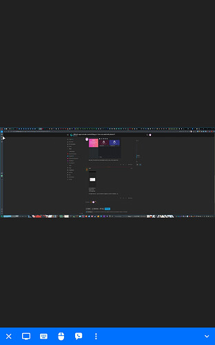

i don’t have problem on my android

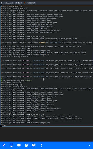

edit : fortunately i do have niri installed, and can confirm, the root issue was niri didn’t set the XDG_SESSION_TYPE, so launching rustdesk with it solve the issue (atleast on my testing)

The environment variable was already set and I could confirm it with echo $XDG_SESSION_TYPE. I’m in the same situation as the last guy in the link you posted. There must be something else that’s causing that. :man_shrugging:
