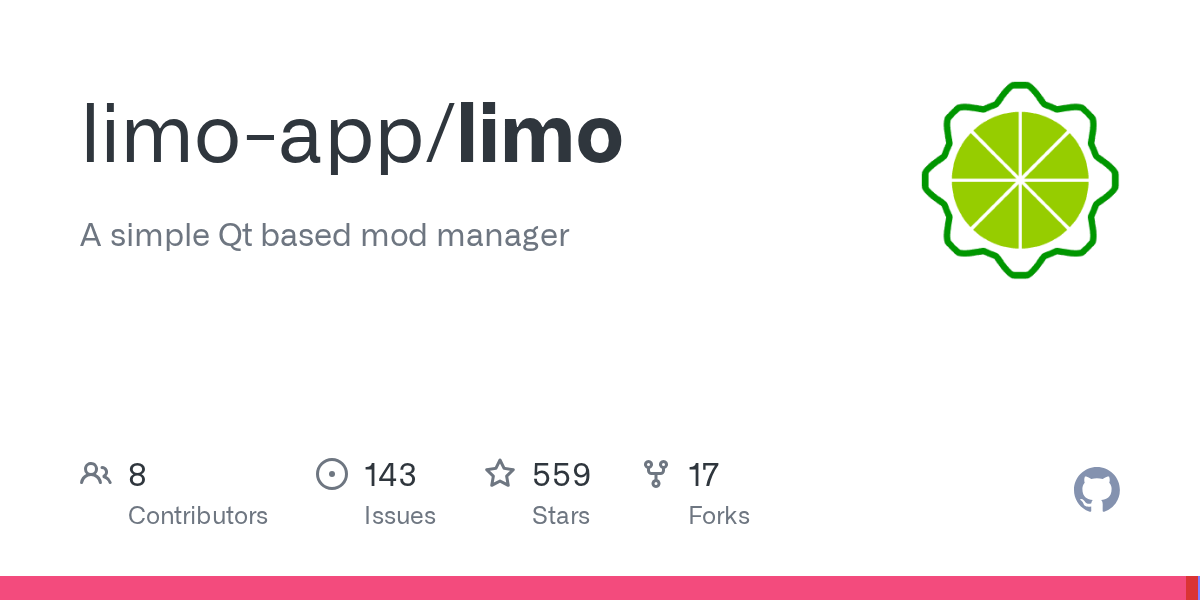

Hey, Vortex is currently Windows only, but there are a few mod loaders that you can take a look at…
Is my favourite and it also works with NexusMods API, and supports LOOT!

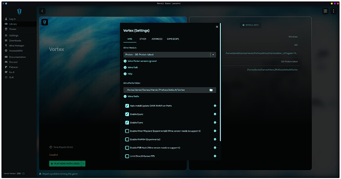

Just in case you’re interested, I’ve been running Vortex through Heroic succesfully. See the attached screenshot.
The install was pretty straightforward, just downloaded the EXE file and ran the installer through Heroic. Though I’d recommend creating a link in an easily reachable location (e.g. ~/games) so you don’t have to click through a lot of directories when installing mods.
I also did not manage to get Nexus to recognize Vortex since I also have their Linux native Nexus Mods App running (but that only supports CP2077 and Stardew Valley) and it just opens that.
The Heroic properties:

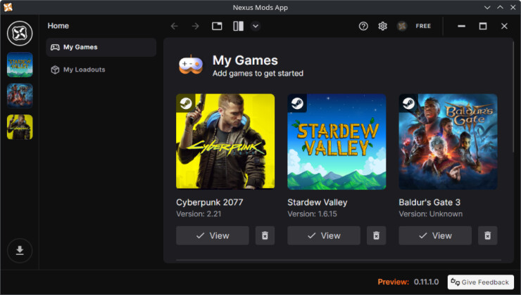

Yeah I had no issues with the Nexus Mods App. It even provides instructions on what to put into Steam launch command and what to install via ProtonTricks.
Just FYI, this is my launch command and a post on ProtonDB:
WINEDLLOVERRIDES="winmm=n,b;version=n,b" %command%
And install vcrun2022 and d3dcompiler_47 via ProtonTricks. Generally I am quite pleased with the NMA, though they could be faster with enabling more games. It has been stuck on those two for nearly half a year now.
