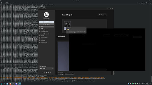

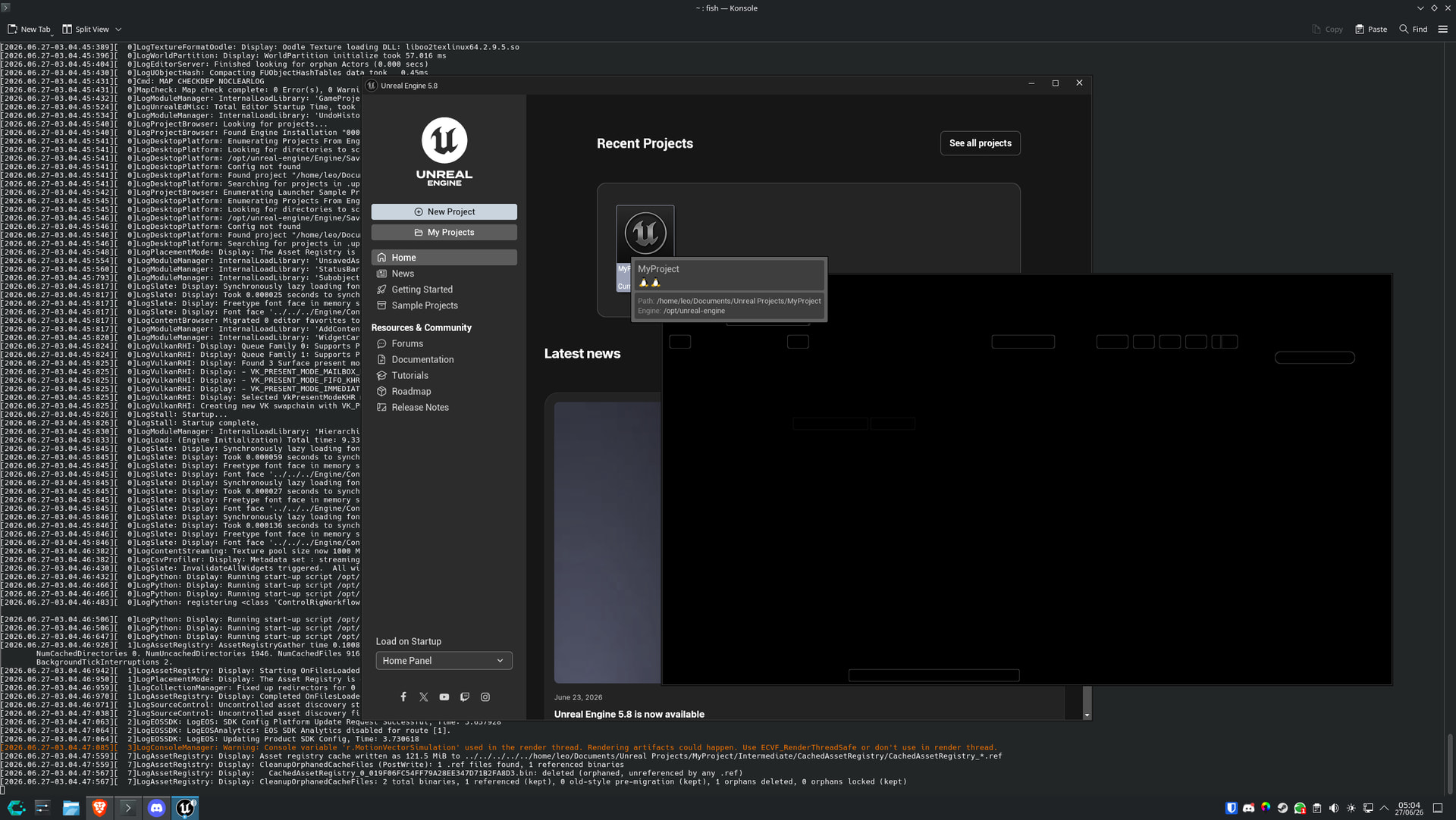

The Project manager starts normally, but when I create a project I see the editor like this:
And then I get this Vulkan error that crashes everything:
radv/amdgpu: The CS has been cancelled because the context is lost. This context is innocent.
\[2026.06.27-03.13.49:533\]\[ 21\]LogVulkanRHI: Error: VulkanRHI::vkQueueSubmit(Queue, InSubmitInfos.Num(), InSubmitInfos.GetData(), FenceHandle) failed, VkResult=-4
 at ./Runtime/VulkanRHI/Private/VulkanQueue.cpp:486
 with error VK_ERROR_DEVICE_LOST
