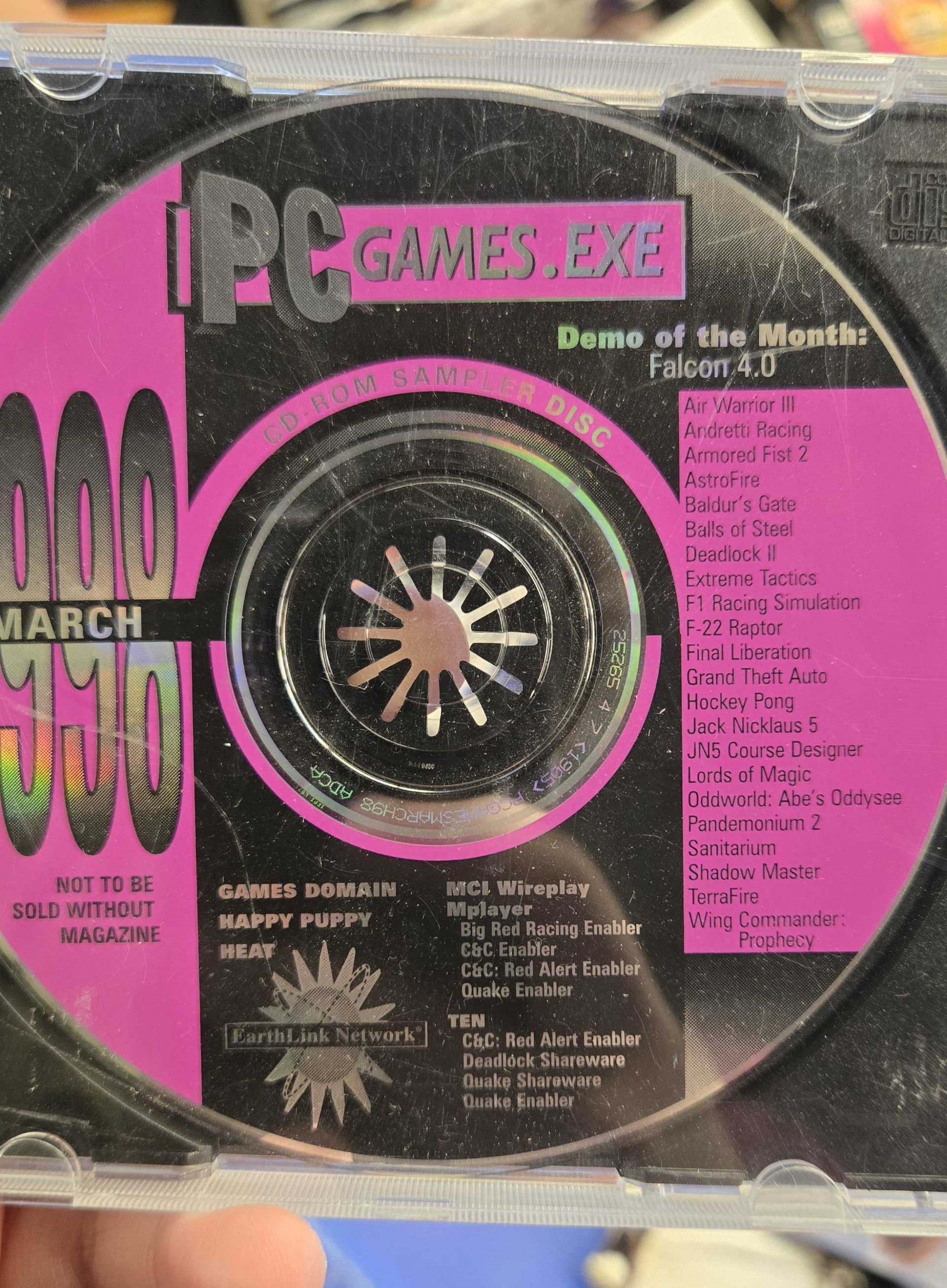

I found a really old CD that has a bunch of game demos from 1998. It wasn’t too scratched up so I bought it for like $1 at a donation warehouse. I was originally hoping I could pass it through to a windows vm I already have working and use their compatibility options to run an old version of Windows that could play.

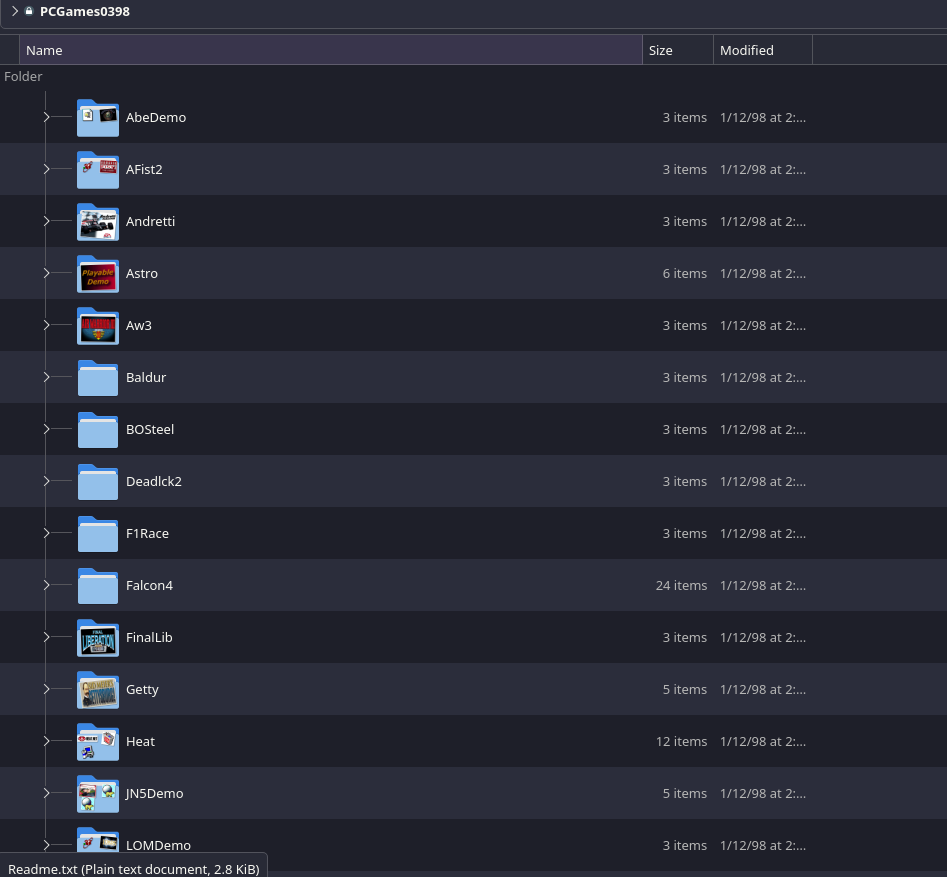

Weirdly enough, it seems to be working today. I’ll consider this fixed
