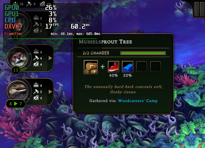

I’m having an issue with the games Against the Storm (AtS) and Songs of Conquest (SoC), both running on the Unity engine.
The problem is that when I enter the menu, I get normal FPS (unlocked in the settings) (in SoC, on the loading screen), but once I get into the game, the FPS drops (SoC menu and gameplay) with DXVK, and the frame times increase in ms. CPU and GPU usage is also higher even before entering gameplay (or the SoC menu).
Unfortunately, I don’t know what’s causing the issue — this is the only problem I have with games on this laptop.

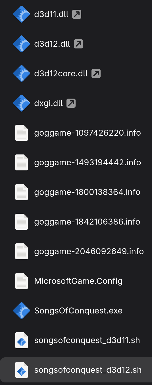

Here’s my setup for Songs of Conquest from GOG:
#!/bin/bash
export VK_LOADER_LAYERS_ENABLE=VK_LAYER_MESA_overlay
export DRI_PRIME=1!
export RADV_EXPERIMENTAL=transfer_queue
export DXVK_CONFIG="dxgi.maxFrameRate = -120"
export WINEDLLOVERRIDES="dxgi,d3d11,d3d12,d3d12core=n,b"
export WINEDEBUG=-all
powerprofilesctl set performance
wine SongsOfConquest.exe -force-d3d12
powerprofilesctl set balanced

I have prime-run, and both games are using dGPU.
Seems like both games aren’t using CPU and dGPU to the fullest
Are you seeing any spiking in fps and or cpu and gpu usage?
