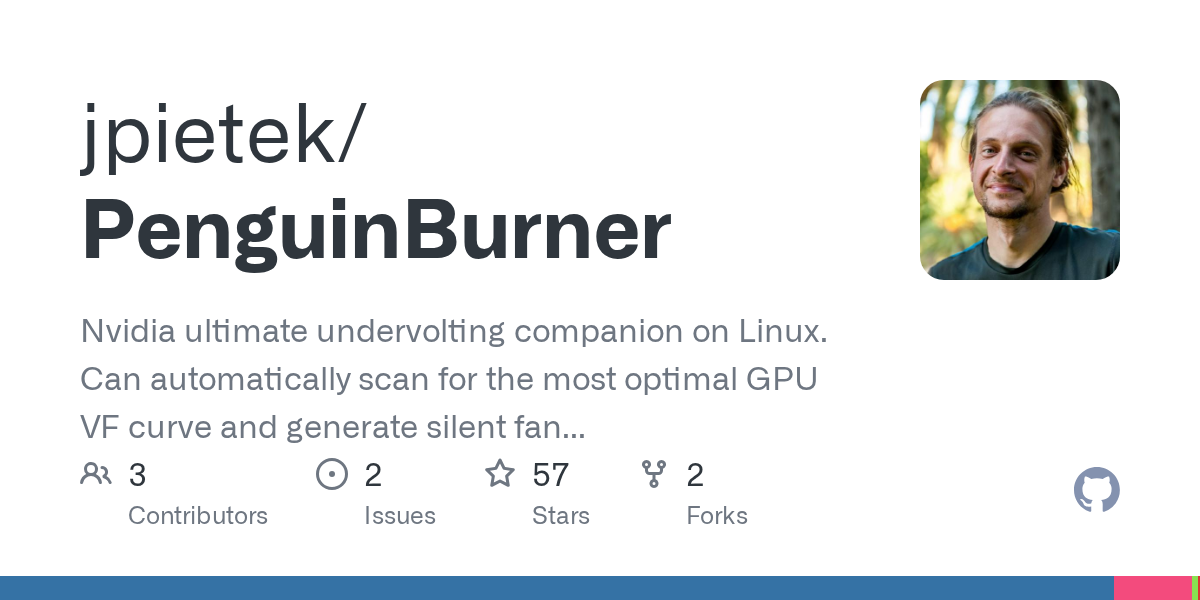

You can try my new app with some adaptive undervolting (optinally UV+OC) with auto scanning for Efficiency, Balanced and Peformance profiles:
It does does all the tedious voltage frequency sweeping of the curve for the most optimal values by the user, around 10 minutes of testing and you are all set. As bonus features: in-game overlay to monitor framerates (pre frame-gen too) and latency plus other params.
It has AUR packages out of the box:
