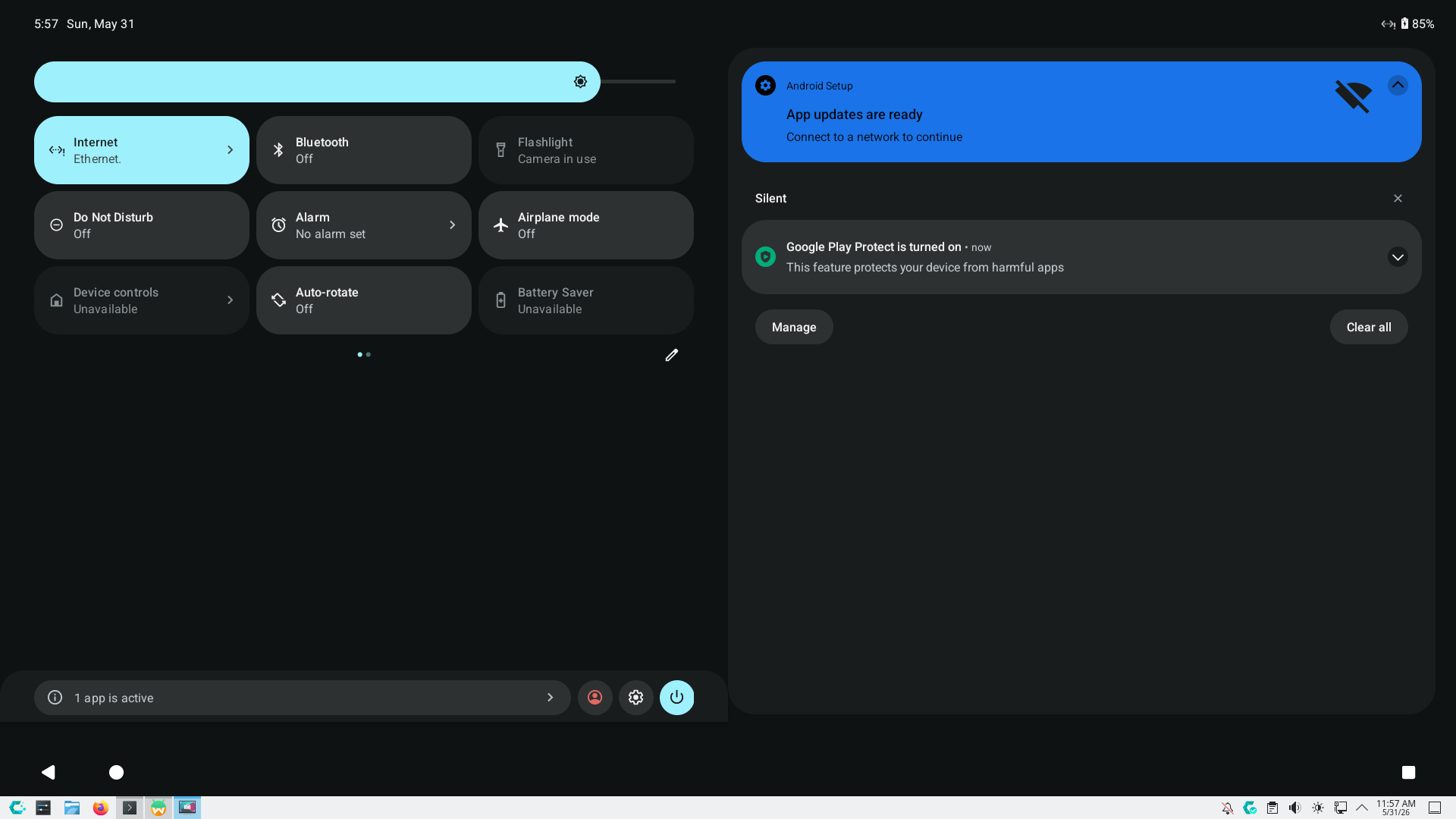

Trying to enable waydroid internet connection
I tried installing Waydroid from but the internet doesn’t work.
I have followed Arch Wiki because I wasn’t able to find any documentation from CachyOS wiki.
I tried initializing with both options.
  1. by installing waydroid-image and running sudo waydroid init -i /usr/share/waydroid-extra/images
  2. by running sudo waydroid init -s GAPPS

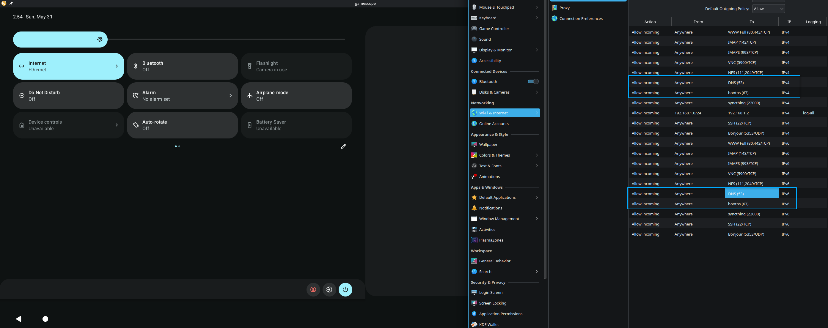

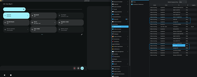

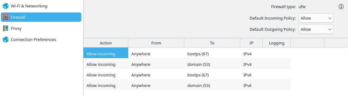

i think you need to add this to your firewall, since i notice you use KDE
53 and 67
Thanks for you response. I think I have these ports open because I have ran ufw allow 53 and ufw allow 67, I also checked it from the settings.
The craziest thing is, even if I disable firewall, it still doesn’t work!

in case the nft-firewall is broken, change LXC_USE_NFT="true" to false
then add the ufw forward port / disable the firewall temporary to test
I did try it a little bit and it didn’t work. I decided not going to tinker with it anymore. I hope it gets fixed someday, if they don’t I might just buy a phone at this point.
CachyOS user also arriving here after trying to install Waydroid. Why is it saying this topic is solved?
The other user above actually installed waydroid fine but could enot enable networking.
Because that same user marked their comment “The problem isn’t with CachyOS. Inside Fedora 44 I’m facing the same issue.” as the solution.
I have now removed it.
Seeing as how the entire thread is not actually about installing waydroid at all I am going to change the title.
Thank you, i appreciate the update. Network access would be absolutely necessary as the primary motivation for even considering Waydroid is to run TiviMate which offers no native Linux (or any other OS) binary
Did you look at any of the linked things?
For example the last comment on that github issue has a response detailing how it actually works fine and docker was the blocking problem the whole time.
It also includes some firewall commands in case they are needed so I might expect with that info you should be able to get it working.
