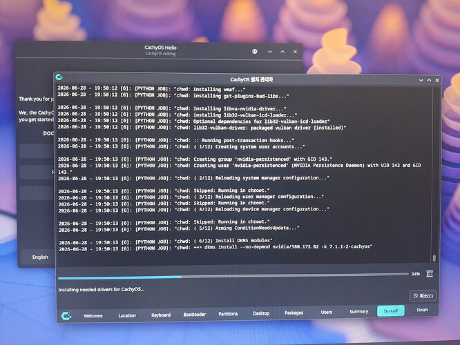

The installation process keeps stopping at 34%
This is my fourth attempt, and the screen freezes at 34% every time. I have even waited for over an hour, but there has been no progress.

I wonder if the installation indeed breaks, or it’s just the GUI. Apparently it happens when dkms compiles nvidia kernel modules. Maybe there’s a bug affecting your configuration. I have nvidia but apparently a newer card (mine is 40 series), so it could be something specific to your setup. Also, things change. There could be some new regressions affecting newer kernels or something.

It always freezes at the ā€˜chwd -> dkms install --no-depmod nvidia...’ step.
