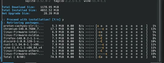

Getting a persistant bug, everytime I run ‘update’ the downloads start at full speed, then start to slow after 20 seconds, then stop completely for a long period of time. I left my laptop on waiting for 30+ minutes and then they started downloading again out of nowhere. So updates do complete but takes an hour or so to do.

Mirrors (rate-mirrors), power-saving on wireless networks, network connectivity that sucks?
Rated mirrors a couple times. no power saving on wireless netowrks that i can see. Laptop is plugged in and in performance mode. (tell me if im missing something)
Network connectivity is fine, every other device has no issues, including this one except for when downloading update packages.
Well that’s what came to my mind….maybe your mirrors just suck?
Im getting the same issue, on different devices too. any help would also be appreciated as I’ve tried all the aforementioned troubleshooting steps
So it does not matter which mirror?
Nothing like this is noticed anywhere else - any other application or use?
When executing sudo pacman -Syu it should print information during the process .. and normally gracefully moves to the next mirror if there is a problem with current one.
