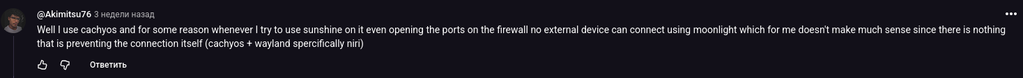

I’ve been trying to fix an issue with screen streaming using Sunshine for a long time. The web UI is accessible and shows no errors, but I can’t connect via Moonlight from any device. Disabling the firewall and port forwarding settings in UFW didn’t help, and installing the Flatpak version made no difference either.
Meanwhile, everything works perfectly on a second PC running Windows. I also noticed someone in the Linux Next comments reporting the same issue (see the screenshot below).
Additional Info:

Heads up: I know nothing of Sunshine and Moonlight, but your log says explicitly:
Error: AppImage and Flatpak do not support KMS capture. Use another capture method.
And more about permissions prior to that.
If i were in your place, i’d research in that direction and also search this forum here, because I believe I saw some people get S/M to work properly.

As I mentioned, I used both versions: Flatpak and the version from the CachyOS repositories
hmmm… strange things, it works on my end without isue tho ?
tho i’m using AMD
might be NVIDIA things ?

also, i’m using this for “Virtual monitor” incase on my end it was fixed with this
This script lists games from Lutris, Heroic, Steam and More, adds them to Sunshine, and optionally downloads game covers from SteamGridDB.
from your log, it seems it has issue with the encoding format
maybe you can try pick non NVIDIA encoder first, to see if thing’s working or not
ZMK
June 13, 2026, 3:31pm
6
Unfortunately, no, it doesn’t work
