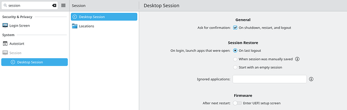

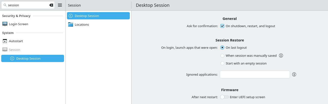

There is an option enabled on KDE Plasma by default is “Session Restore”, if you set it to “Start with an empty session”, it should fix one of your problems.
This helped on this end, thank you.
