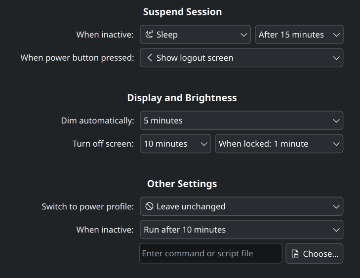

I have the same issue although it is seemingly random. About 30% of the time the system will wake up as expected. Otherwise it requires powering down and back on. My Power Management settings are shown below.
