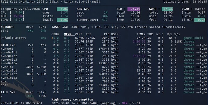

Your problem when it comes to hibernation is most likely this:
zram can easily break the sleep cycle if your memory usage is too high. I had the same problem until I disabled it.
This blog post shows a reference to this happening and explains some of the cons of using it on certain systems.
It’s also mentioned in the arch wiki that it doesn’t support hibernating to disk aka swap hibernation.

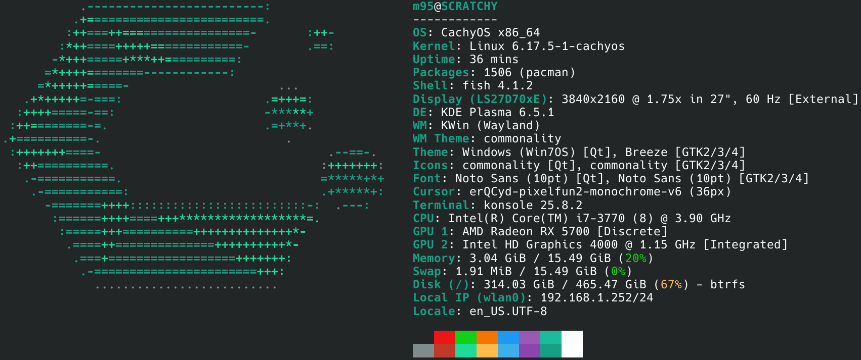

This thread helped me fix this problem on my own machine. Thanks y’all!
Because of that, and because I had spare time and scratch for the model requests, I used opencode and a rogue’s gallery of recent models to grind out a tool for automating the zram-zswap change with backups and automated rollback: GitHub - boundring/cachyos-zswap-migrate: Interactive, logged, reversible CachyOS zram->zswap + hibernation swapfile migration tool Ā· GitHub
hope that helps anybody at all, haven’t put in the time and effort for getting dracut handled in that yet
