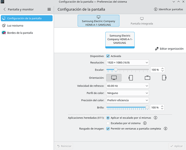

Weird problem, is the refresh rate set too high? Can you make screen shot of the monitor settings in cachyos?
There are the settings. This TV screen supports a max of 60 Hz, which is the setting I have been using for ever. I’m starting to notice it more: I move the cursor before the screen turns itself off and definitely things feel smoother before than after. If I switch back to my native laptop screen for example I get perfect refresh rate and “feeling” that I don’t get after the tv screen glitches.
A new thing I notice is that in the brief period between me login in and the screen turning itself off is that I lose control over the TV. It doesn’t respond to commands, it ignores if I try to shut it down, etc. It only returns to normal after it reboots itself, but with this issue. Could it be that either KWin or KDE are interfering somehow with the screen or the internal OS of the TV in some way? Because I ran some tests the last few days, and this issue is happening on all Smart TVs I hook my computer to, but not on normal old screens.
I never had a problem like this. If TV react like this, it’s usally because the signal from a source is either out of specs or too “strong” like to high refresh rate.
I don’t know the solution. Maybe you can try to lower the brightness set it to 30%, change Precision del color too “Prefer color accuracy” and update the TV. Also on thing sometimes a monitor / TV reacts weird if you have set to 60 Hz try it with 59.94 Hz. This all I can think off sorry.
