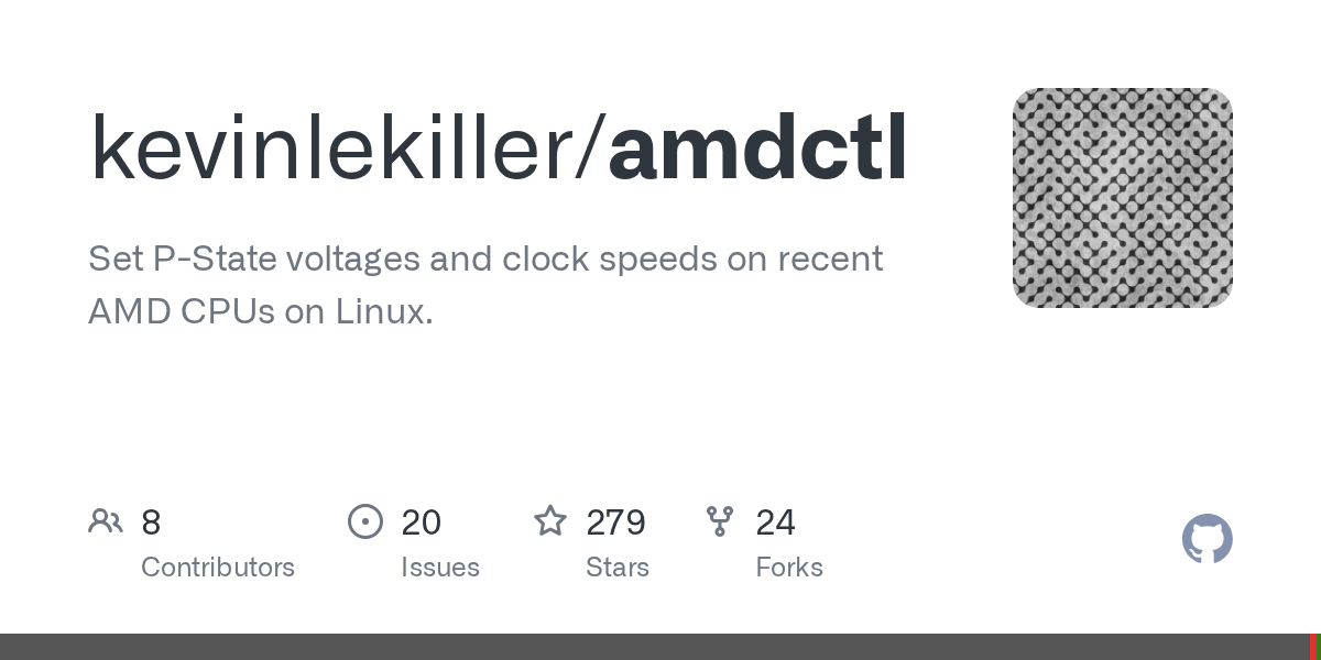

Hello and welcome,
I would probably actually stop and use amdctl instead.
It is listed at Undervolting CPU - ArchWiki and apparently only supports up to zen3 .. but you have a zen3. :slight_smile:
amdctl is in the AUR. You should become familiar with it before using and at least read the PKGBUILDs. See more here;
But Cachy does come with paru aur-helper by default so to get going you could;
First make sure you are up to date and all;
sudo pacman -Syu
Then use paru to install amdctl;
paru -S amdctl-git
On how to use amdctl you would consult its docs and for undervolting specifically this section;
