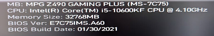

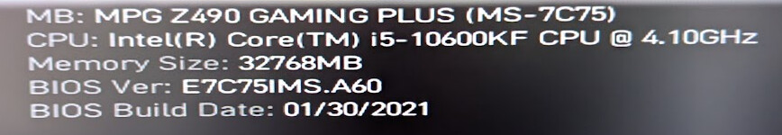

Little hardware info: I’m using a msi z490 gaming plus board.

Which BIOS Version is your Board on?

The model of board is a bit newer on my end, i thought z490 was the model :laughing:
Product Name: MEG Z490 UNIFY (MS-7C71)
I am using the BIOS A.E0.
