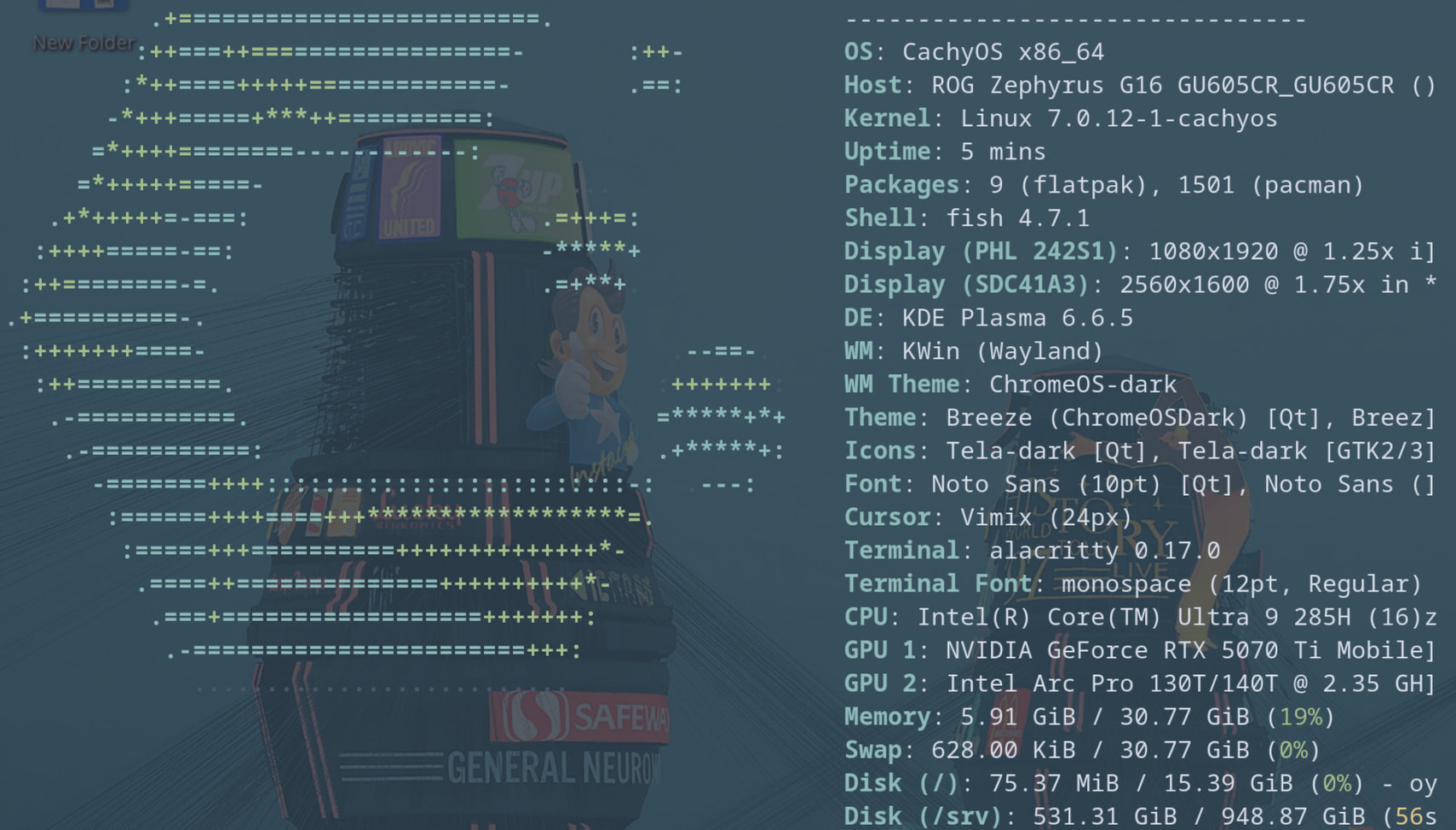

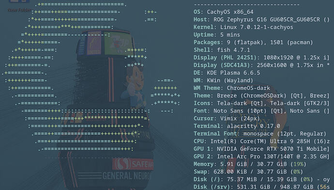

I don’t know the specific update causing the issue (i was hit with 147 at once), but i have narrowed it down to KDE, Wayland, or Plasma. The behavior i am seeing is when I plug in a Display Port External Monitor to my HP displaylink dock screen goes black with mouse cursor visible. Keybound Shortcuts bring up their apps, and Ctrl+Alt+Del works to reboot nothing else works. Un plugging the DP monitor does nothing until reboot with it disconnected. Rolled back to before updates and everything works normal.

pretty much ruled out any update that isn’t (ironically) version 6.7
bug report when external monitor is working: 4107064
