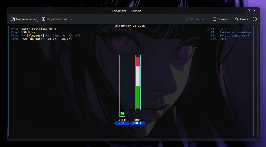

I have also investigated the behavior in alsamixer before and after the update.
On the working 7.0.x kernel, there are two volume sliders available for the device: PCM and PCM 1 (as shown in the screenshot below).
However, after updating to the 7.1.x kernel, the following happens:
  1. The second slider (PCM 1) completely disappears from alsamixer.
  2. The first slider (PCM) immediately drops to 0 as soon as the system master volume goes below 34%.
This strongly suggests that the updated kernel driver fails to properly detect and map the dual-slider mixer topology of the Razer Leviathan V2 X USB mixer grid, causing a premature hard mute.
