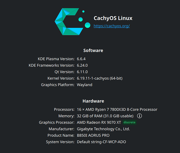

Even after a fresh install, I’m getting what appears to be a random White Screen Flash either on desktop or in gaming when HDR & VRR is enabled. It is inconsistent but frequent enough to be annoying LOL.
I know this was a problem about 6 months ago, but I was under the impression this has been solved.
Are others still reporting this is an issue? or what troubleshooting steps should I take?… considering I want both HDR and VRR enabled.
Troubleshooting Steps Taken:
  • Disabled LACT undervolt
  • Color Accuracy - Perfer Efficiency
  • 10bit and 8 Bit
  • Refresh Rate: 60Hz, 120Hz & 165Hz
  • Swapped DP cable - DP80
  • Disabled eGPU on AMD 7800x3D CPU
Monitor: ASUS XG32UCWG 165Hz 10bit 4k Freesync (VRR 48-165)

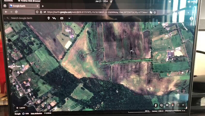

Have you seen this?
Thank you for the share Thor :slight_smile:
This example is quite extreme. I only observe a single flash randomly that can span minutes to hours. Very hard to point the issue. Trialing a few now and will report back my findings.
