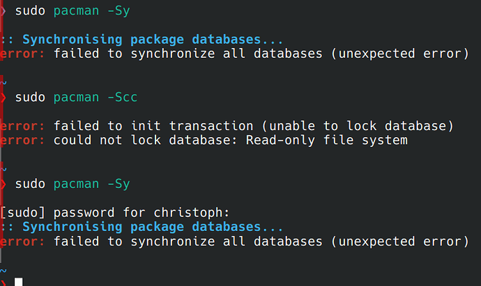

Bambu Studio still does not want to start and now I have some odd issues of error message likes there:

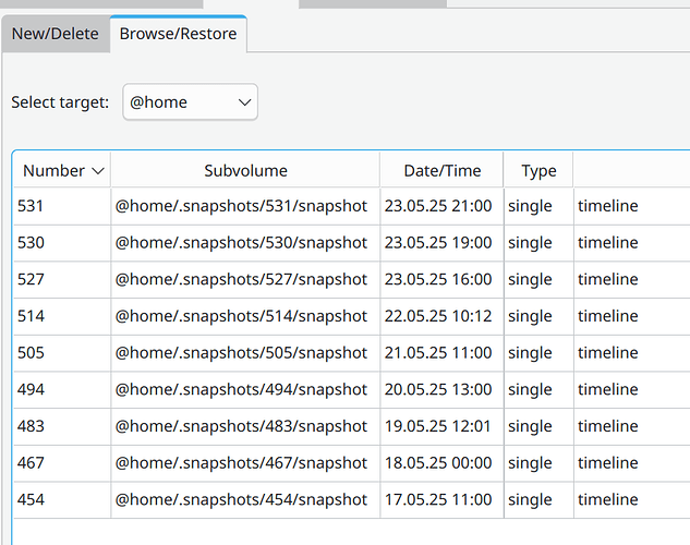

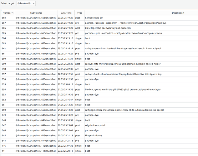

This is the situation now in my BTRFs manager:

So from your screenshots it looks like step 10 wasn’t successful (This is the step where you move the snapshots from the @.broken directory back to the newly created @ directory that you copied from the “good” snapshot. That is why BTRFS manager is showing the snapshots are still located in the @.broken directory.
Here is a link to that article:
You may have to boot off the usb drive to move it, I’m not sure what impact moving it on a live system would be.
the other issue is you just need to remove the database lock whenever you restore a snapshot (this is normal because the snapshots occur during the pacman process so the database is locked when the snapshot takes place so when you replace one of those snapshots the database is in a locked state).
You can either use the button in the CachyOS Helllo app by clicking the Apps/Tweaks button, and then clicking the button that says Remove db lock.
The other way is just to enter the command that that button is doing for you which is:
sudo rm /var/lib/pacman/db.lck
Once you do that the database will no longer be locked.
It is probably good that it was locked because I’m not sure where it would have created the snapshots since they are still under the @.broken directory. It probably would have created a new @/.snapshots directory but I don’t know for sure. Anyway the good news is you caught it before that happened. Just make sure that the snapshots are in the proper directory (@/.snapshots/) before you remove the database lock and start running pacman again.
Also a final note is the very end of that “How to restore a Snapper root snapshot on an unbootable system” I talk about the final cleanup of deleting the @.broken directory once your are back on a good snapshot. Just make sure your /.snapshots/ directory is moved out of the @.broken directory before cleaning up that snapshot. you can do the cleanup in BTRFS Assistant once it all looks good just go to the Subvolumes tab and delete @.broken there. Just as I said make sure you have successfully moved the /.snapshots/ folder over to the @ subvolume before you do so.
