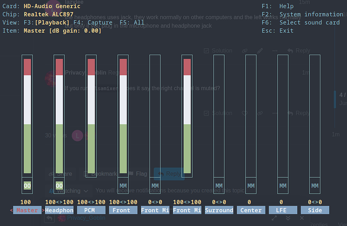

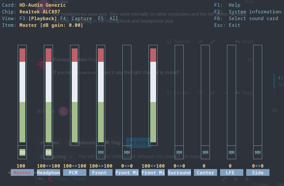

If you run alsamixer, does it say the right channel is muted?

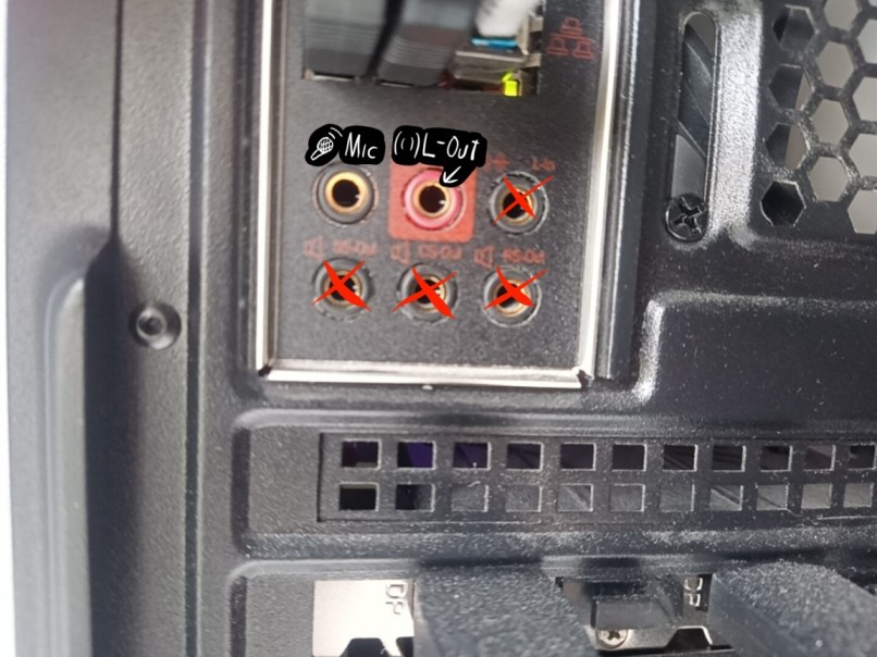

Are you using front panel port? Have you tried the back port instead? Maybe something with front panel cable
This may be obvious, are you sure you are getting the jack all the way inserted?
I have had instances where some jacks were a little stiff and needed a little more force to get the plug all the way in.
