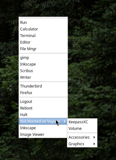

What brought me here is I tried I tried dropping in my .config/openbox folder from another linux and edited the files to make it all work.
However my right click menu was only partially correct, and the submenu is cut short cutting most of the categories. Is there another config file causing this?
