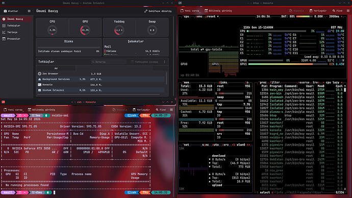

Usage Spikes: When the system is completely idle, GPU usage sits around 1%–2% and draws about 6W. However, randomly, as soon as I open a simple application (this happens almost every time I open the terminal, or sometimes when opening Zen Browser), the GPU usage immediately spikes to 50%–100%, and the power consumption jumps from 6W to 17W–18W.
Process Mismatch: Interestingly, nvidia-smi shows no active processes under the process list, but btop and KDE System Monitor report 90%–100% GPU utilization.
Stuck in Performance Level 3: In the NVIDIA Settings panel, I can see that the GPU gets completely locked at "Performance Level 3" (highest performance state) during these spikes. This keeps the laptop idling at around 50°C with high power consumption.

Just a quick observation, your nvidia-smi shows that no processes are using it.
Exactly, that is precisely what puzzles me as well—why it indicates such high utilization even during periods of inactivity.
Because that’s your integrated GPU, not the 3050. The dedicated one is GPU0 in btop.
By design, the iGPU is preferred on a laptop for desktop activity, while the dGPU is reserved for gaming and the like.
See this wiki page for details: Dual GPU Setup Guide | CachyOS
nvidia-smi is reporting power state P8, so it is correctly in a low power state due to not being used.
The high temperature is likely just due to the poor thermals typical to the cramped nature of a laptop. In a laptop, CPU and GPU often have a connected heatsink, so heat from the CPU travels to the GPU heatsink when the GPU is inactive. This helps dissipate the heat in the limited space / ventilation available.
