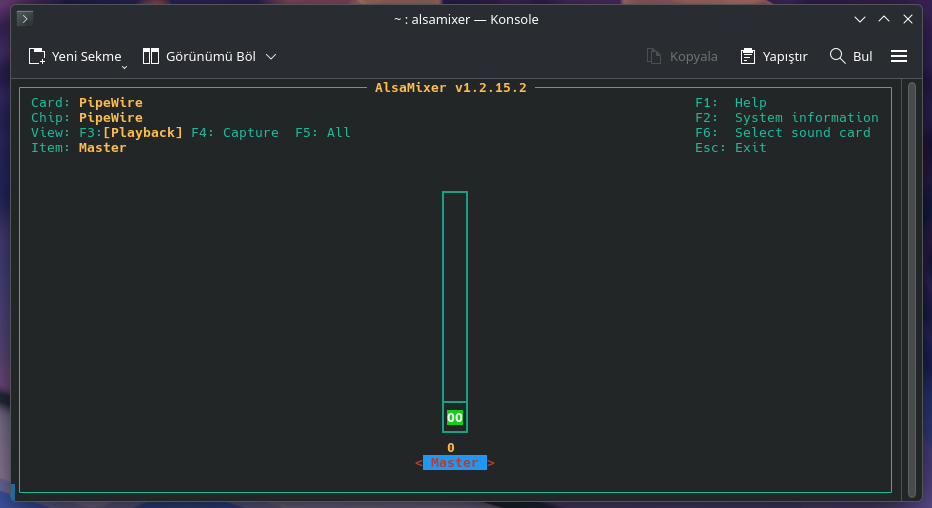

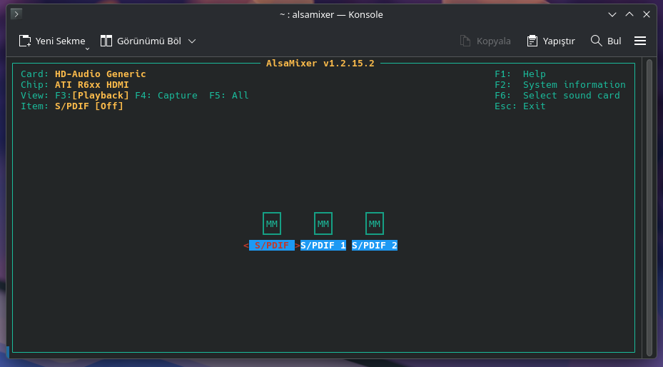

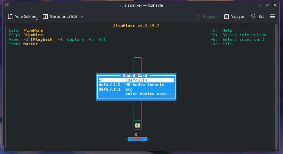

I just looked at alsamixer, and I’ll share some screenshot because sadly I didn’t understand anything.
I did the bugreport too, after reading your comment, should I share the bugreport link here as well?
The screenshots: (it didn’t let me put more sceenshots, only one because it says I’m a new user)
But the first screen I’m seeing is this when I write ‘alsamixer’.
And this is what I see when I clicked F6:
So could none of those be increased or unmuted?

I don’t know how to use alsamixer but I tried to move some and unmute some but it looks like nothing changed. It still says there is no input or output.
Or maybe I did it wrong with alsamixer. Is there a guide to how I can use it?
