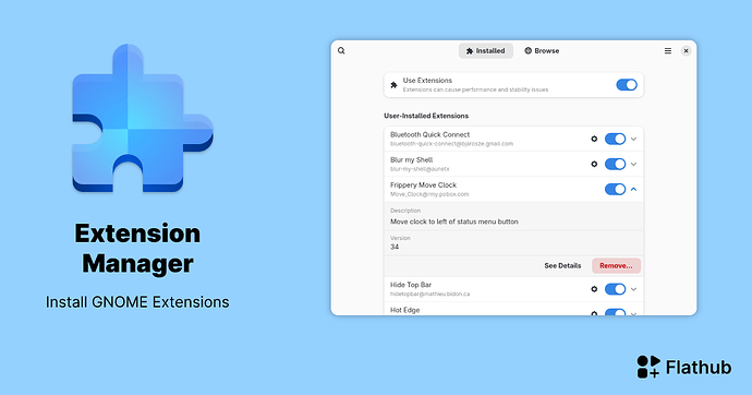

Also both of these environments are highly polished, so frustrations you’ll have with switching will mostly be a temporary thing since your brain needs to get used to it. (I love both KDE and GNOME). And if bottom taskbar aesthetics is on your priority list, try the GNOME extensions: Dash to Panel and ArcMenu (they’re awesome)
For installing extensions use the Extension Manager app.[1][2]

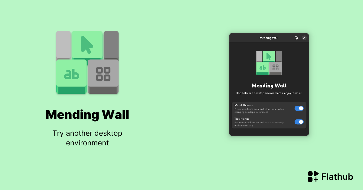

Installing GNOME alongside KDE flawlessly using Mending Wall
After installing Mending Wall you:
  1. Open the app
  2. Toggle on both Mend Themes and Tidy Menus
Next thing is installing GNOME. This can be done using a single package group called gnome[3]
But we’ll also install gnome-console to be sure since Konsole, KDE’s default terminal, will hidden from the launch menu due to Mending Wall.
sudo pacman -S gnome gnome-console
Use the default options, 'cause you can always uninstall unnecessary stuff later.
After the installation is done, log out. Now in within the login screen, there will be an option to switch the session to GNOME (some kind of dropdown menu). After selecting GNOME, log in again and you’re done! Both GNOME and KDE now work on your machine.
