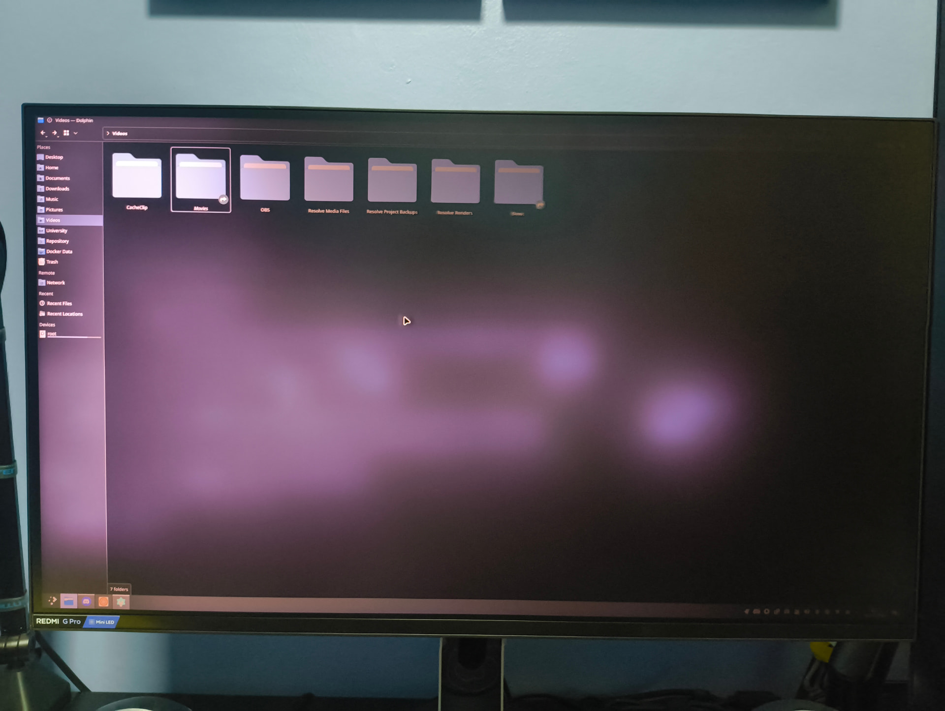

As what the title said, my mini-led backlight gets stuck when playing an HDR video or stutter in full screen games. Picture shows where the local dimming zones getting stuck even when exiting the application. Only way to reset the monitor is by turning it off and on again.

Currently I’m trying to find a way to reproduce it as consistently as possible because even HDR videos only triggers it sometimes. The only trend I found is it occurs when a big stutter happens & is in fullscreen. So far the only cases where it is triggered is:
  • HDR videos
  • Launching a game in fullscreen
    • This sometimes leaves the screen completely black as the local dimming zones are all stuck at 0.
  • Mid game
