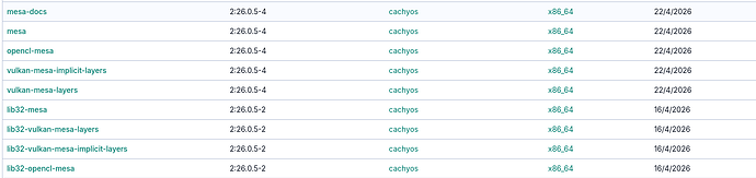

Locally I can see that
> sudo pacman -Syyu
cachyos/lib32-mesa                         1:26.0.5-1   2:26.0.5-2     2,63 MiB
cachyos/lib32-opencl-mesa                  1:26.0.5-1   2:26.0.5-2     0,66 MiB
cachyos/lib32-vulkan-mesa-implicit-layers  1:26.0.5-1   2:26.0.5-2     0,00 MiB
cachyos/lib32-vulkan-radeon                1:26.0.5-1   2:26.0.5-2     0,49 MiB
cachyos/mesa                               1:26.0.5-1   2:26.0.5-4     0,09 MiB
cachyos/opencl-mesa                        1:26.0.5-1   2:26.0.5-4    -1,40 MiB
cachyos/vulkan-mesa-implicit-layers        1:26.0.5-1   2:26.0.5-4     0,00 MiB
cachyos/vulkan-radeon                      1:26.0.5-1   2:26.0.5-4    -0,02 MiB
Yesterday when libs where updated to 2:26.0.5-2 and 2:26.0.5-4 my games crashed after 10-15min mostly all the time
The first time:after waiting 2 days libs32 got updated and everything was fixed
Today the same happened and by downgrading to 1:26.0.5-1 everything was fixed
So is it something expected how could I prevent it to happen while still being able to update regularly?
It’s not my mirror that is late it seems normal. (I forced all mirror lists to the same source)
In the meantime I will create a small script to check futur versions but I feel I’m missing something
Thanks for any help
