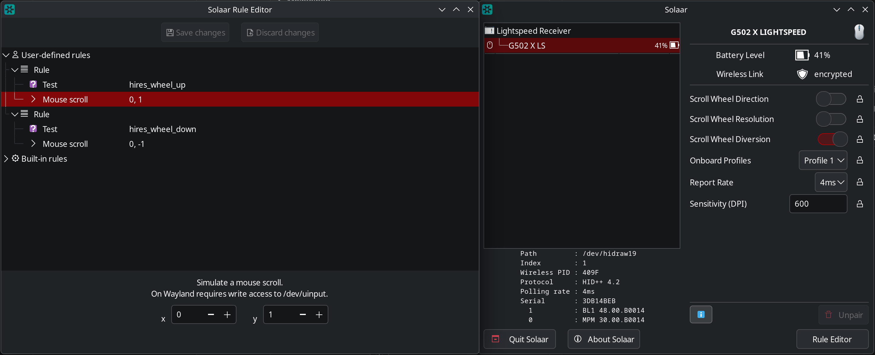

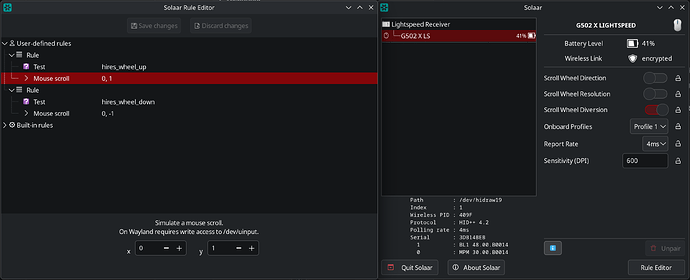

Workaround 2 (Using Solaar):
Foreword: This was my original “fix” to the problem, it is still working, however, it’s not as reliable as it was in 6.19, now in 7.0, after some time or some event (I haven’t yet tracked down), the scroll wheel switches to a hybrid hi-res mode. This fix for 6.19 made scrolling binary just like how it works in 6.18, you either scroll 1 unit up or down, however this new bug in 7.0 causes it to scroll smoothly between two “clicks”, it’s still 1 scroll per scroll, but more “analog”. Restarting Solaar fixes it.
The fix is simple, capture hid++ events related to the scroll wheel and convert them to discrete scroll inputs in Solaar. The below image is all you have to setup.
I’ve been using the blacklist workaround for awhile now, but recently KDE XWayland (All XWayland apps) started crashing when I scroll fast.
EDIT: Looks like the workaround stopped working too, my scroll wheel is back to being absolutely unusable, if I turn my mouse off and on it works fine for a bit, but probably after it sleeps it goes back to unusable.
The Solaar rules seem to work, hopefully fixes the crash and issue permanently. This mouse is literally unusable with highres scrolling that’s default on and can’t be turned off.
Nope Solaar fix is no better, still fails after mouse sleep, still KDE Xwayland crashes when scrolling too fast, guess I’m stuck downgrading to an unsupported unpatched kernel to fix this.
