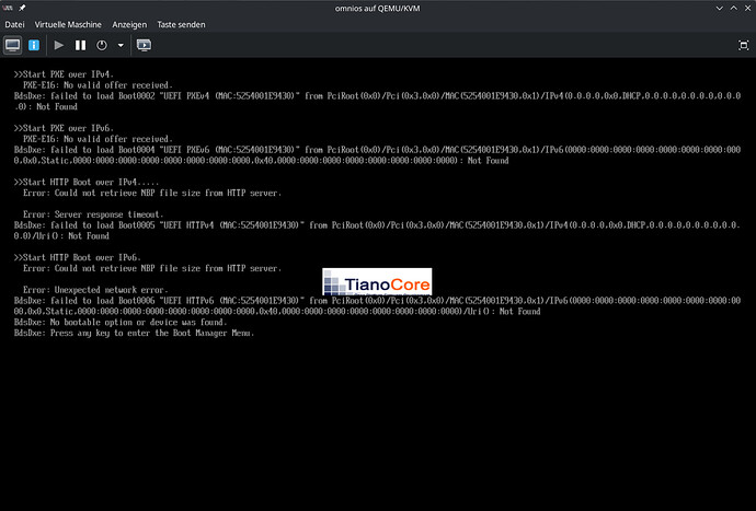

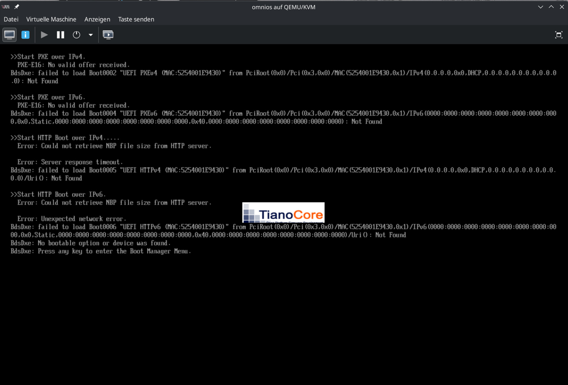

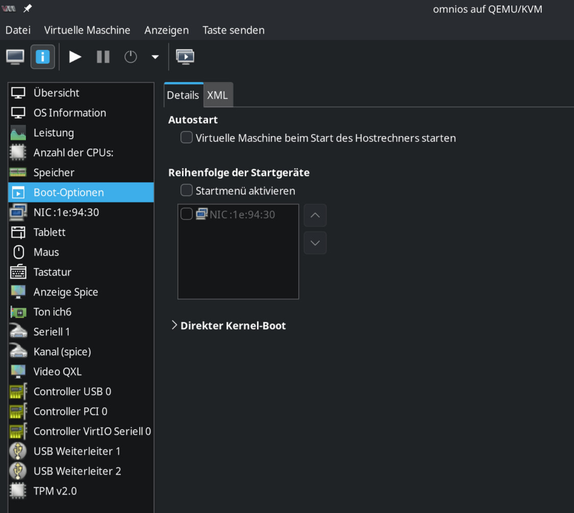

“Boot Options”: Looks like NIC/PXE is selected.
Do you boot over the network, too? If not, deselect it pls.
No, I never used this, and not even the vm configuration did:
Where is the cdrom?
There should be one and empty:
IDE CDROM 1 Source path: No media selected
I had to import the vm after I restored an earlier snapshot I made!
There is no cdrom then, but I already added one again, only to be sure that it wouldn’t change anything. I tried it but got same results as before.

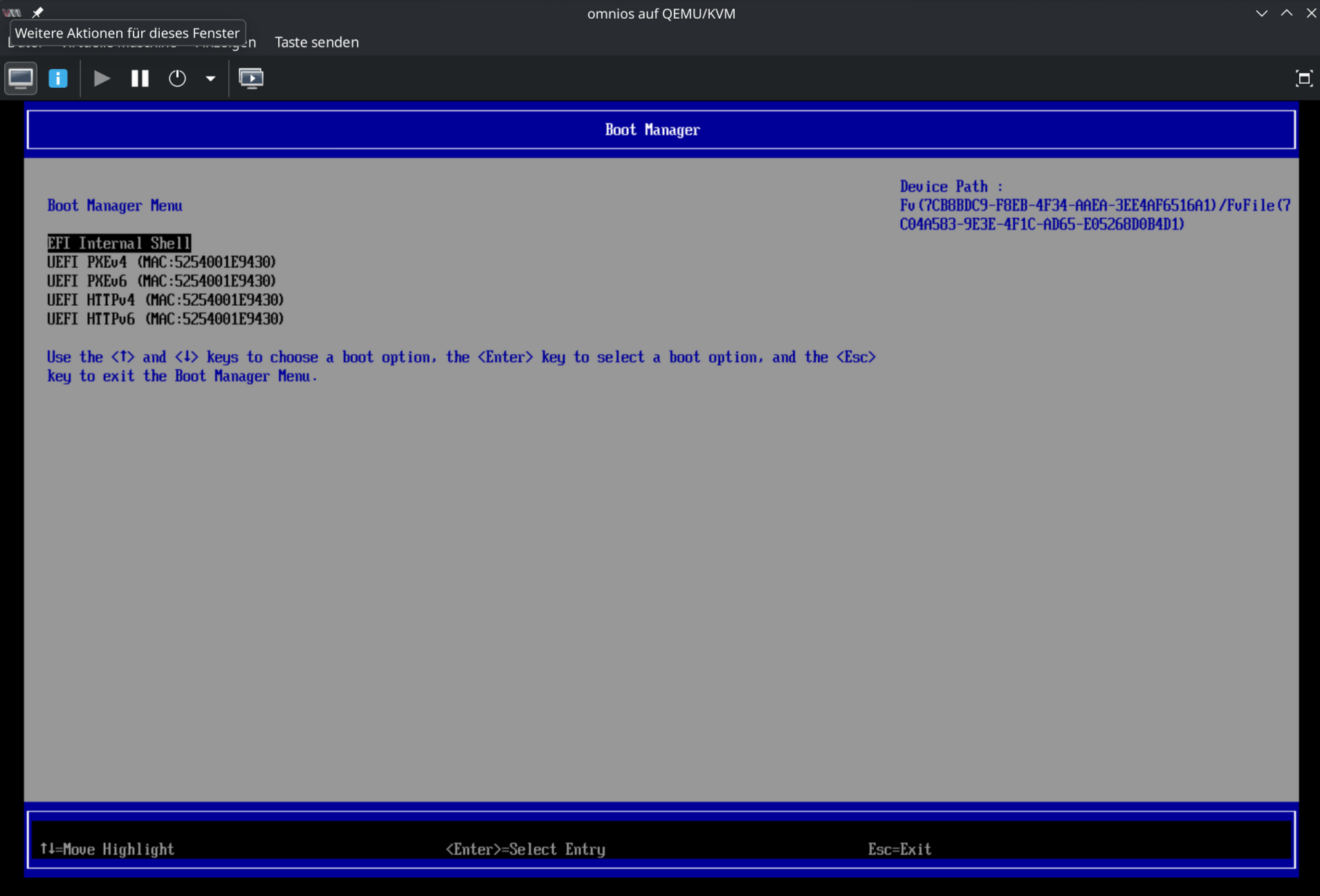

After entering the vm’s bios I could enter the Boot Manager from the bios. But you can’t do anything there, not disable or delete one of the entries.
How do you enter a vm bios?
There should be neither a VM nor any VirtIO Disk 1.
Just an empty ide cdrom.
I suspect this is the BIOS that virsh installs in the background to boot a specific operating system. I think this has something to do with the operating system selection, which it attempts to automatically detect when selecting an operating system ISO file. Or rather, the one that you have to enter manually to boot an unrecognized operating system.
You can access the BIOS after it attempts to boot from the network. See the first image I uploaded. Then you just press ENTER and you’re in the VM’s BIOS.
