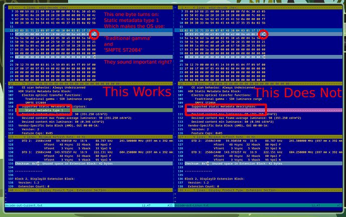

I then took my edid.bin and followed Arch wiki’s instructions to get in place and overriding the firmware one, edited mkinit.conf and bootloader, mkinit’d, rebooted, toggled on HDR, and it worked! Okay, so now I have a functional HDR monitor, but I still didn’t know exactly what was wrong with the original edid, so many edid-decodes, and vimdiff’s later I found ONE byte difference between a working HDR monitor and not, that bit toggled on, “Static metadata type 1”. Okay, not an edid expert, but if I had to guess this tells the OS to use ‘Traditional Gamma’ and ‘SMPTE ST2084’, those sound fairly important to me.
Went back to the original edid, flipped the bit, redid checksum, mkinit’d, reboot, worked!
