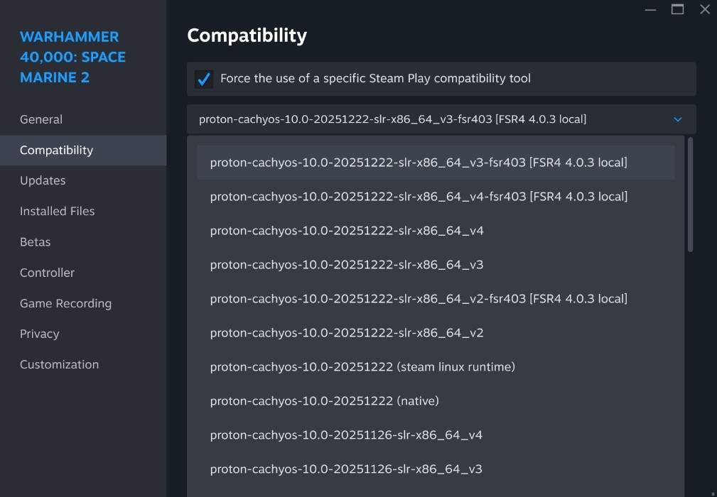

- **RDNA3/RDNA3.5:** `PROTON_FSR4_RDNA3_UPGRADE=4.0.3`
- **RDNA4:** `PROTON_FSR4_UPGRADE=4.0.3`

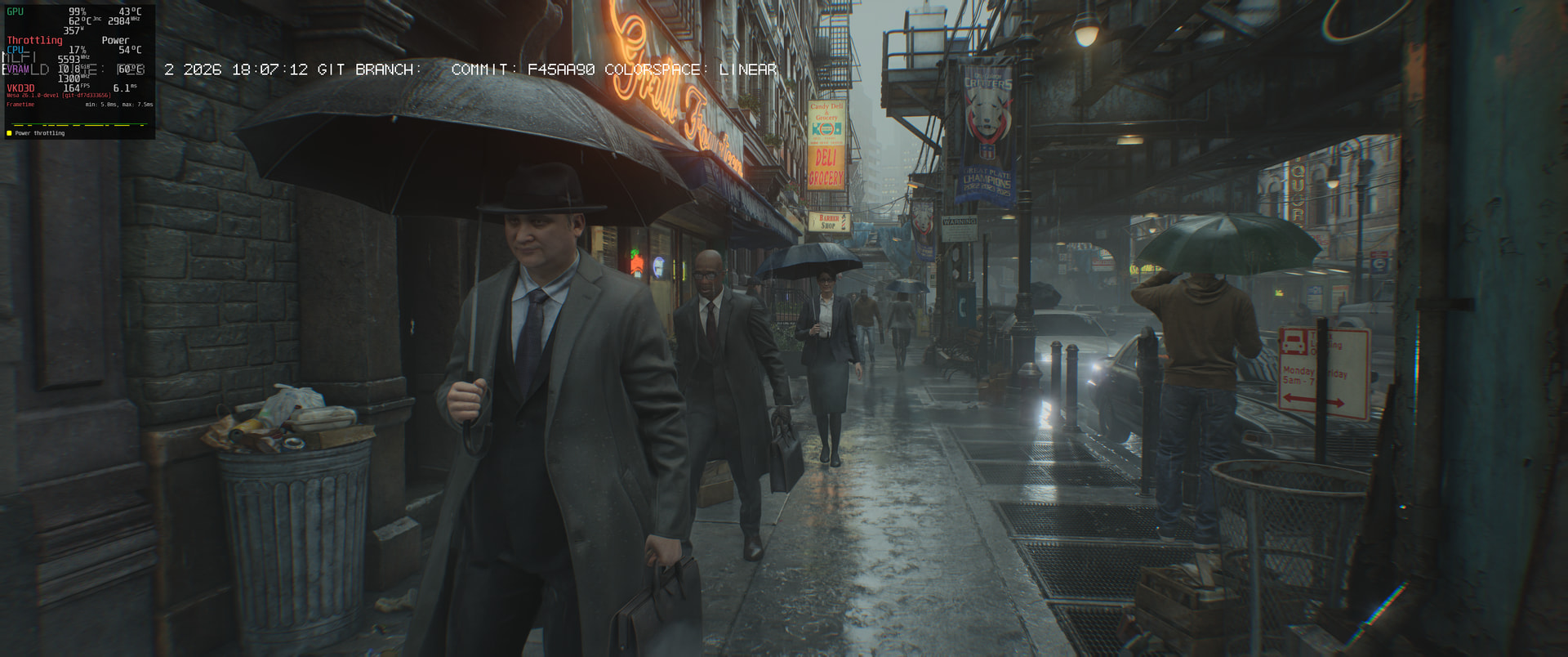

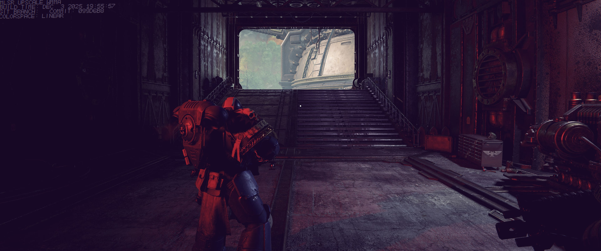

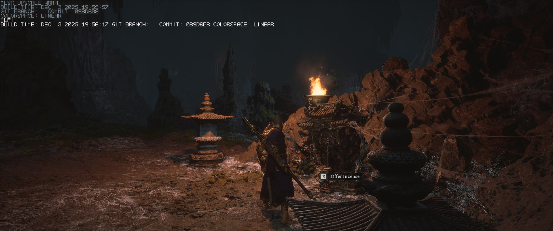

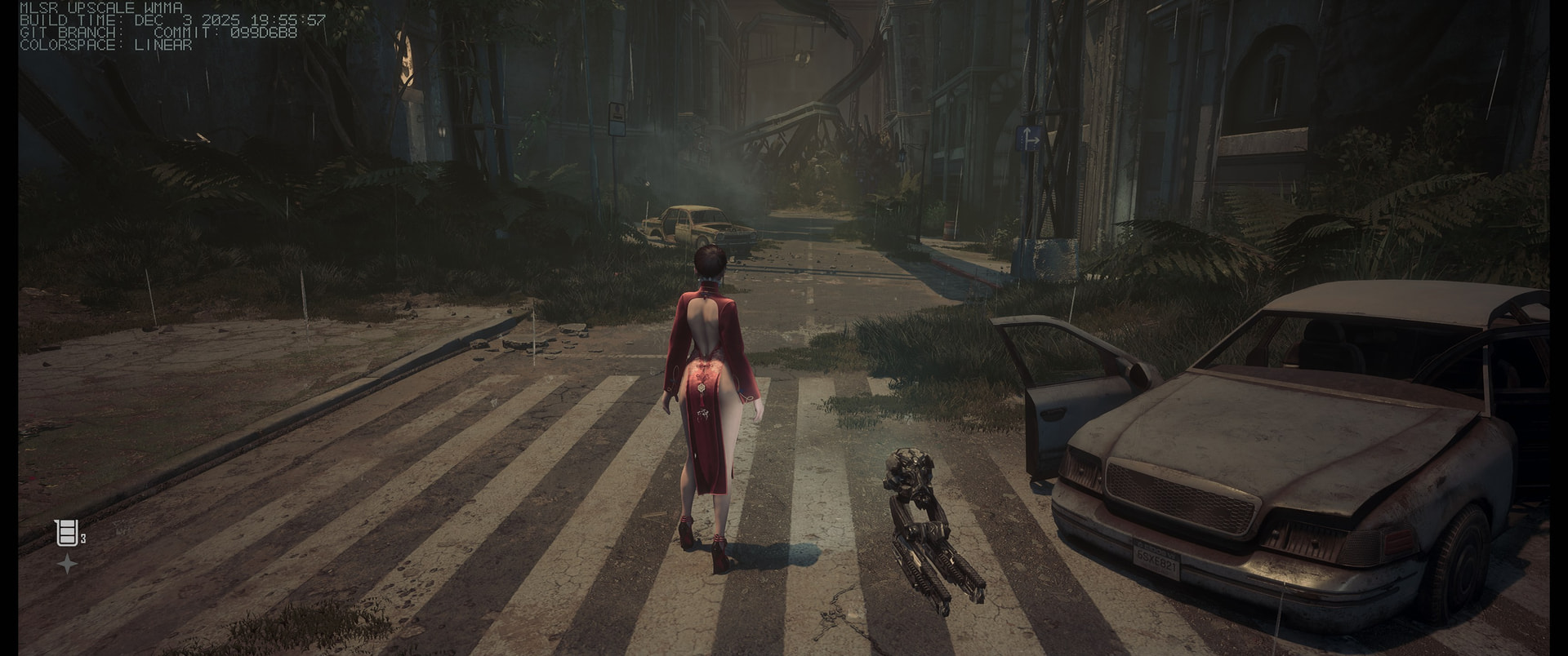

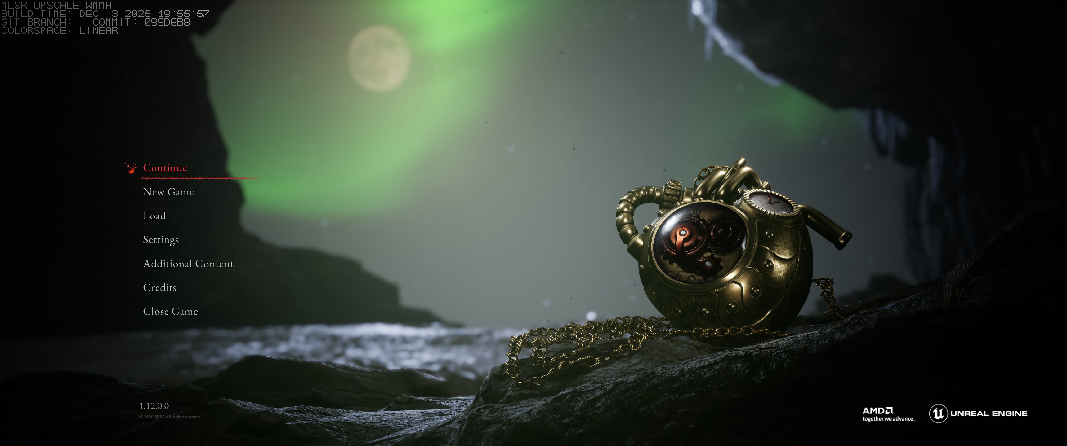

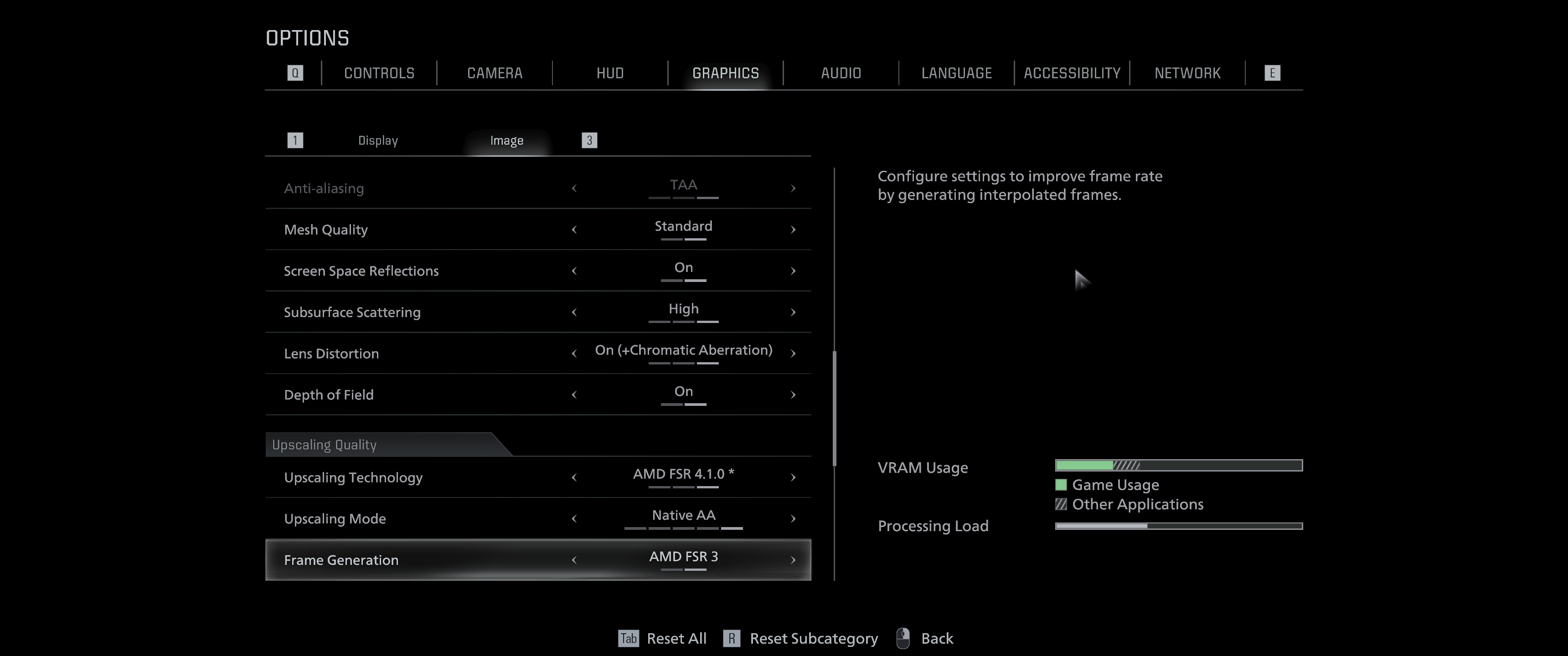

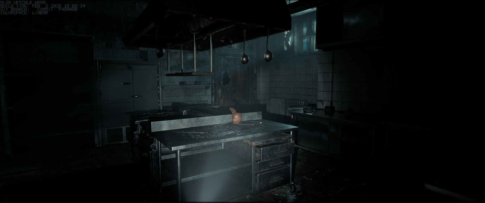

And yep — **here are a couple of in-game screenshots as proof-of-concept / it’s working:** 📸👇

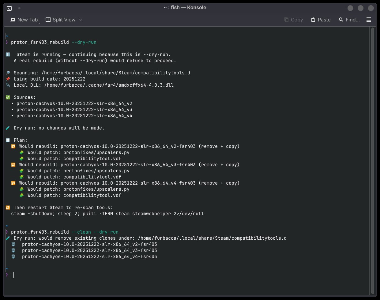

# FSR4 4.0.3 local tools (Fish) 🧰
This repo/bundle contains **two Fish functions**:
- **`amd_fsr4_install`** — fetches and extracts AMD’s **FSR4 4.0.3 `amdxcffx64.dll`** from an AMD driver package and places it in your cache (default: `~/.cache/fsr4/amdxcffx64-4.0.3.dll`).
- **`proton_fsr403_rebuild`** — clones **Proton-CachyOS** compatibility tools into `*-fsr403` variants and patches them so Proton can use the **local FSR4 4.0.3 DLL** via environment variables.
> ✅ **Low-risk by design:** `proton_fsr403_rebuild` **clones** your existing Proton-CachyOS tools into `*-fsr403` folders and only edits the **clones** (original `_v2/_v3/_v4` tools stay untouched).
> 🛡️ **Fail-safes:** no sudo • refuses real rebuilds while Steam is open • `--dry-run` plan mode • `.bak` backups + rollback on failure • `py_compile` validation of patched `upscalers.py` • `--clean` removes only the clones.
> ⚠️ Still, **use at your own risk** (you’re changing files under your Steam compatibility tools directory).

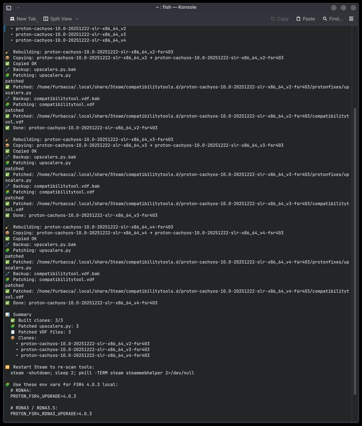

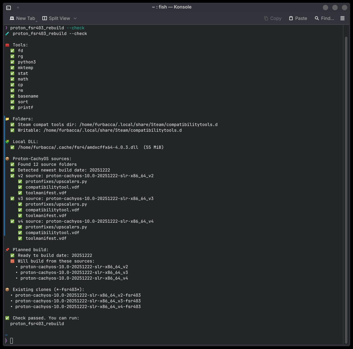

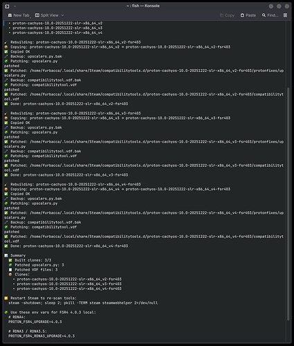

## 2) Build Proton-CachyOS `*-fsr403` clones
Preflight:
proton_fsr403_rebuild --check
Plan mode (no changes):
proton_fsr403_rebuild --dry-run
Real run (close Steam first):
Clean (remove clones):
proton_fsr403_rebuild --clean

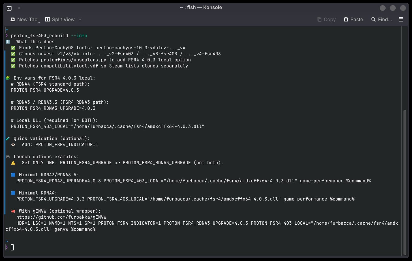

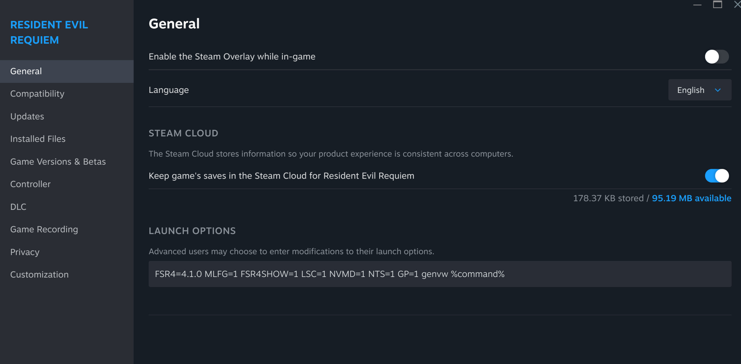

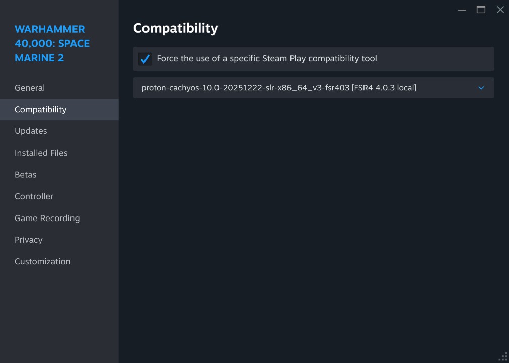

## 🎮 Steam launch options (FSR4 4.0.3 local)
Use **only one** upgrade var (**don’t set both at once**):
### RDNA4
PROTON_FSR4_UPGRADE=4.0.3 PROTON_FSR4_403_LOCAL="$HOME/.cache/fsr4/amdxcffx64-4.0.3.dll" game-performance %command%
### RDNA3 / RDNA3.5
PROTON_FSR4_RDNA3_UPGRADE=4.0.3 PROTON_FSR4_403_LOCAL="$HOME/.cache/fsr4/amdxcffx64-4.0.3.dll" game-performance %command%
(Optional) indicator:
PROTON_FSR4_INDICATOR=1

- Tool not showing in Steam: restart Steam (it only re-scans compatibility tools on startup).
- Game won’t launch: run `proton_fsr403_rebuild --check`, confirm the DLL exists at `~/.cache/fsr4/amdxcffx64-4.0.3.dll`, and make sure you set **only one** of `PROTON_FSR4_UPGRADE` / `PROTON_FSR4_RDNA3_UPGRADE`.
- Need logs: add `PROTON_LOG=1` to launch options and check `~/steam-<appid>.log`.

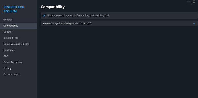

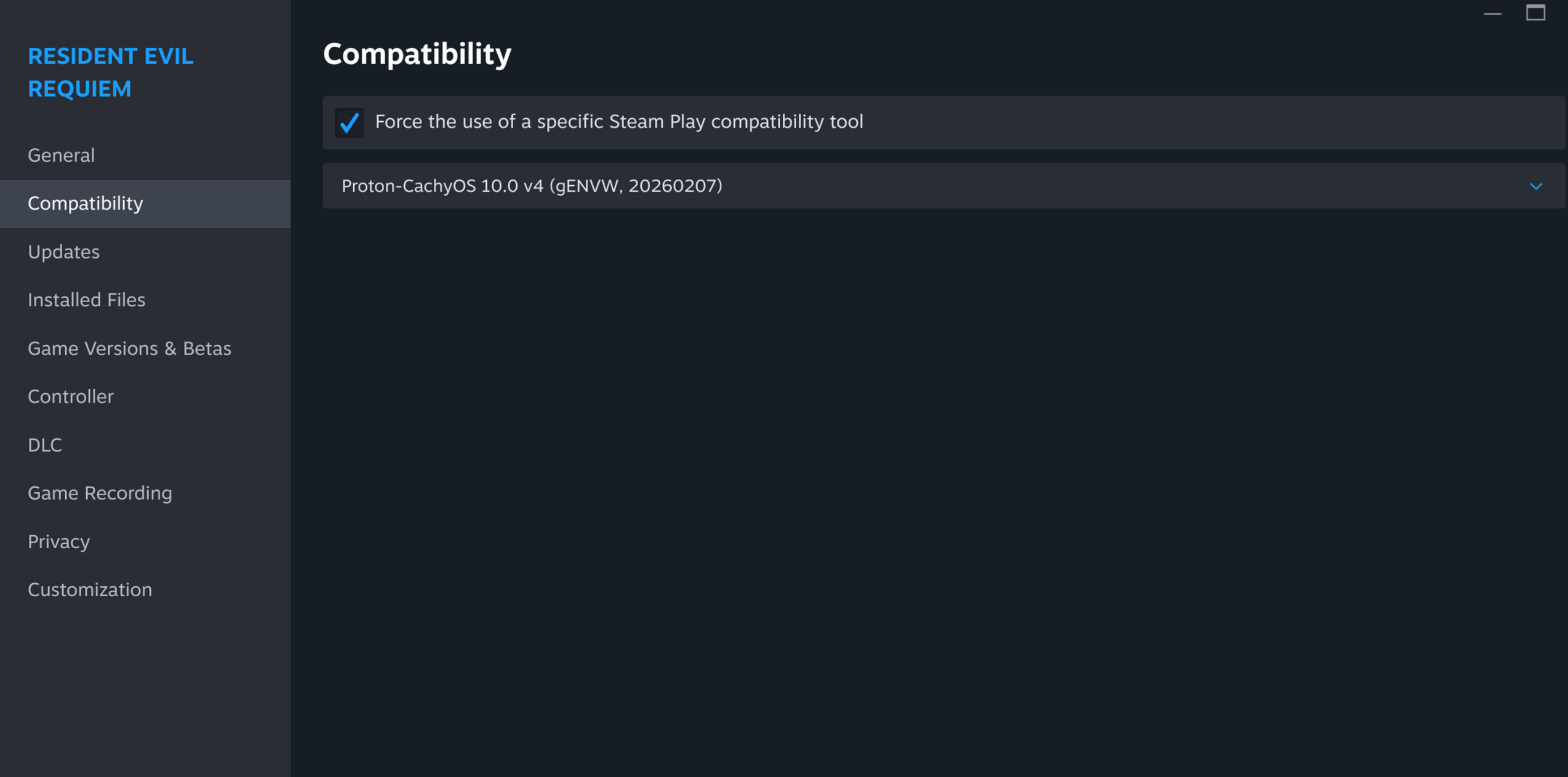

gENVW custom Patched CachyOS Proton
gENVW launch options in steam

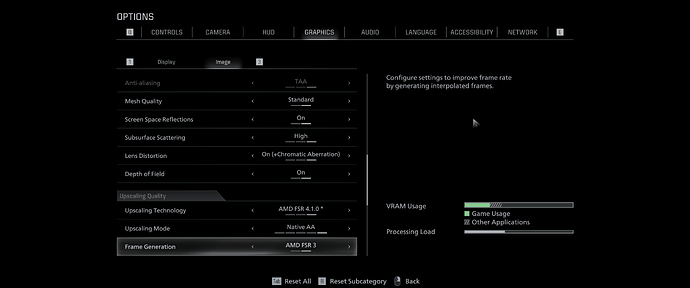

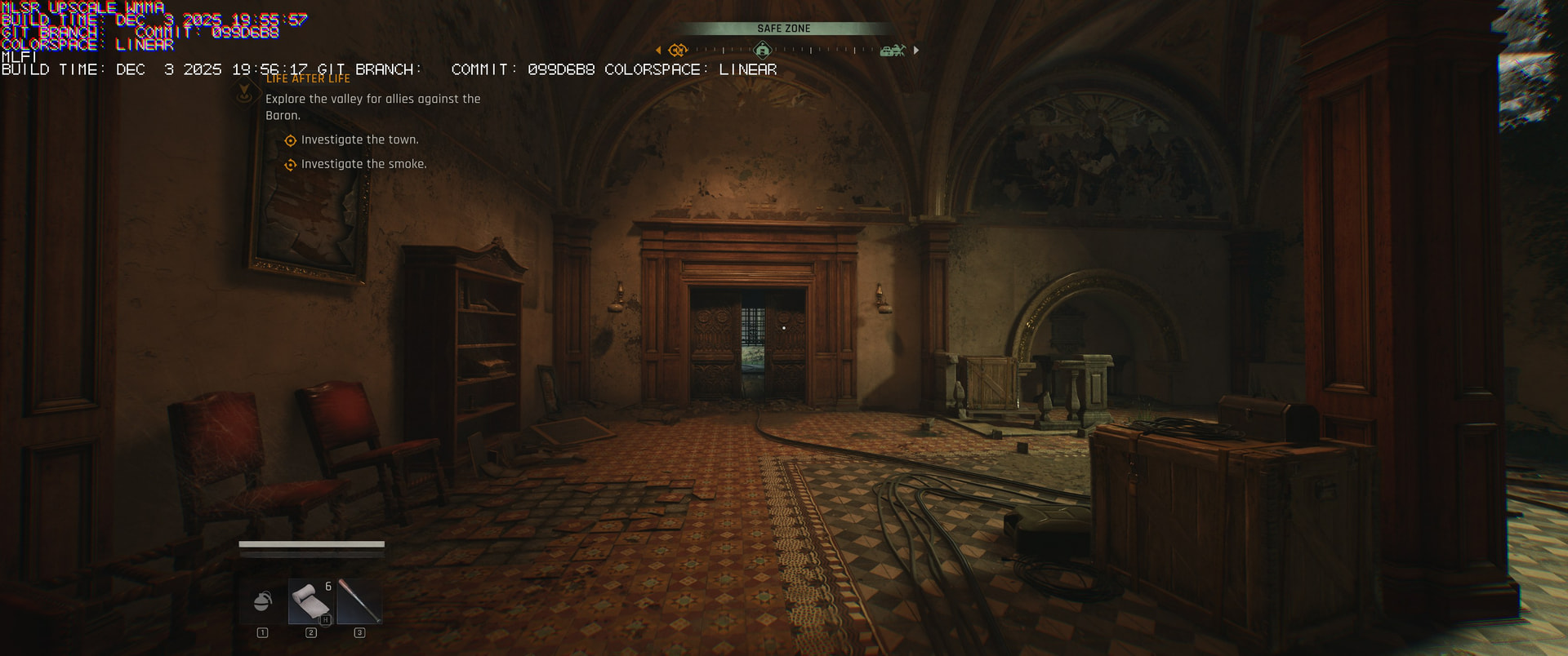

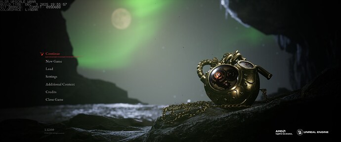

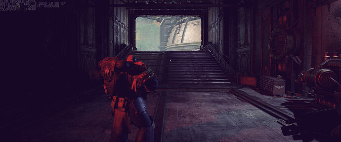

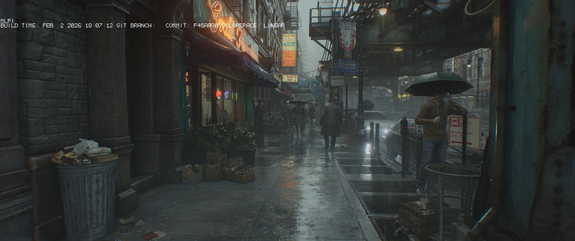

In Game Options.
As soon you can see from FPS4 Overlay build date is FSR4 4.1.0
Looks like everthing is working on gENVW end. I added a direct --dll install option instead of just --exe/url and then having my CLI app search for FSR4 driver.
Just an example of new FSR4 ver install using gENVW. This release is not public as of yet. i still have a few issues to solve. Should push it to repo in less then a week.

:white_check_mark: Installed: /home/furbacca/.cache/protonfixes/upscalers/genvw/amdxcffx64_v4.1.0.dll
sha256: 446e27b7eab3213a1fcb584516fcf24ffbdeb23be72136f3633e508320e71813
md5: 2401cb24a41a6609d67af99322c4959b
:white_check_mark: Meta: /home/furbacca/.cache/protonfixes/upscalers/genvw/amdxcffx64_v4.1.0.meta.txt
:white_check_mark: Report: /home/furbacca/.cache/protonfixes/upscalers/genvw/amdxcffx64_v4.1.0.report.txt
:shield: Provenance integrity: :white_check_mark: META_MATCH=1 (ok)
:shield: Allowlist: :white_check_mark: ALLOWLIST_MATCH=1 (ok)
:cross_mark: prefix-sync: prefix DLL not found
:information_source: appid: 3764200
After running the game/in-game
[furbacca@cachyos-x ~]$ genvw proton dll prefix-sync --ver 4.1.0 --appid 3764200
:warning: prefix-sync: prefix DLL looks in use; close the game/Steam before syncing
:information_source: Tip: run this while the game is not running
:play_button: prefix-sync: installing cache DLL into prefix (creates amdxcffx64.dll.~N~ backup if existing)
cache: /home/furbacca/.cache/protonfixes/upscalers/genvw/amdxcffx64_v4.1.0.dll
pfx: /media/games/SteamLibrary/steamapps/compatdata/3764200/pfx/drive_c/windows/system32/amdxcffx64.dll
:white_check_mark: prefix-sync: prefix DLL updated
backup: /media/games/SteamLibrary/steamapps/compatdata/3764200/pfx/drive_c/windows/system32/amdxcffx64.dll.~1~
PFX_DLL=/media/games/SteamLibrary/steamapps/compatdata/3764200/pfx/drive_c/windows/system32/amdxcffx64.dll
PFX_SHA256=446e27b7eab3213a1fcb584516fcf24ffbdeb23be72136f3633e508320e71813
CACHE_DLL=/home/furbacca/.cache/protonfixes/upscalers/genvw/amdxcffx64_v4.1.0.dll
CACHE_SHA256=446e27b7eab3213a1fcb584516fcf24ffbdeb23be72136f3633e508320e71813
:white_check_mark: MATCH: prefix DLL matches cache DLL (v4.1.0)
Nice job!
I also got it working too; but man, does 4.1.0 look bad (with notable flickering like FSR3)! Maybe it works better on RDNA4?
