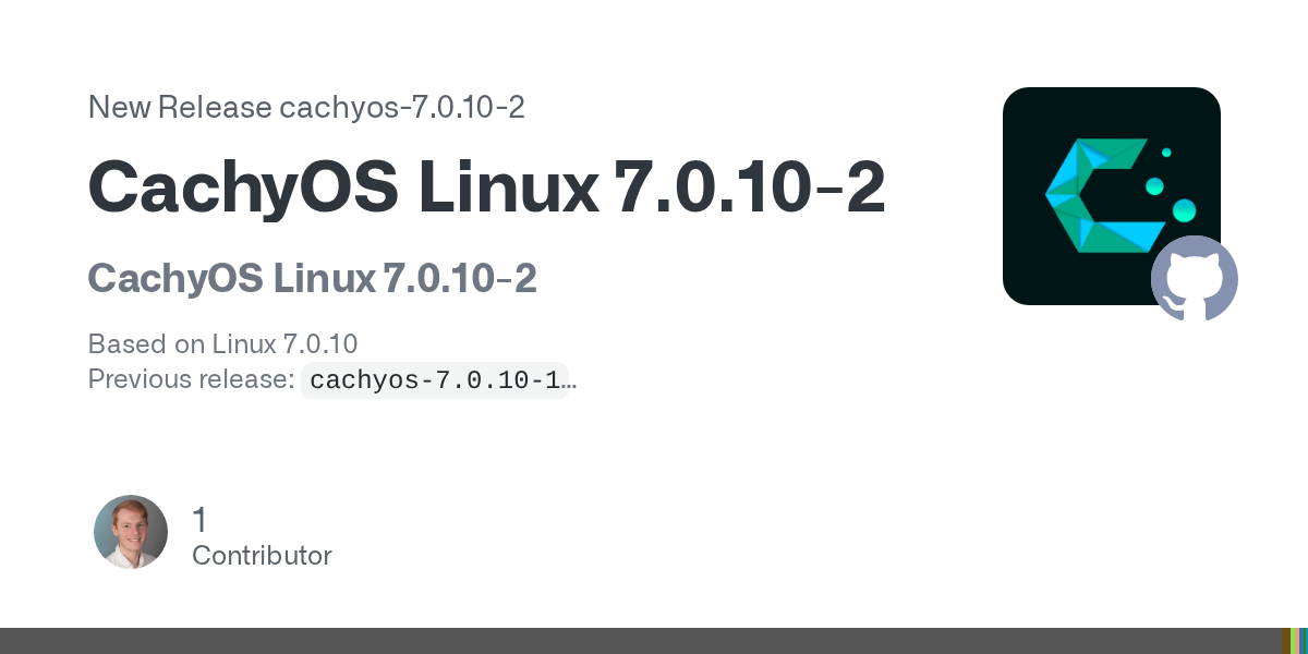

It attempts to use 7.0.10-2 which is the previous release. The latest version is 7.0.11-1 which released yesterday. If it is simply failing to find the .asc file from the 7.0.10-2 release, presumably building from the 7.0.11-1 release would not cause this error because the .asc file is present for that release.
(contains 3 assets, none of which are the .asc signature)
(contains 4 assets, including the .asc signature)
