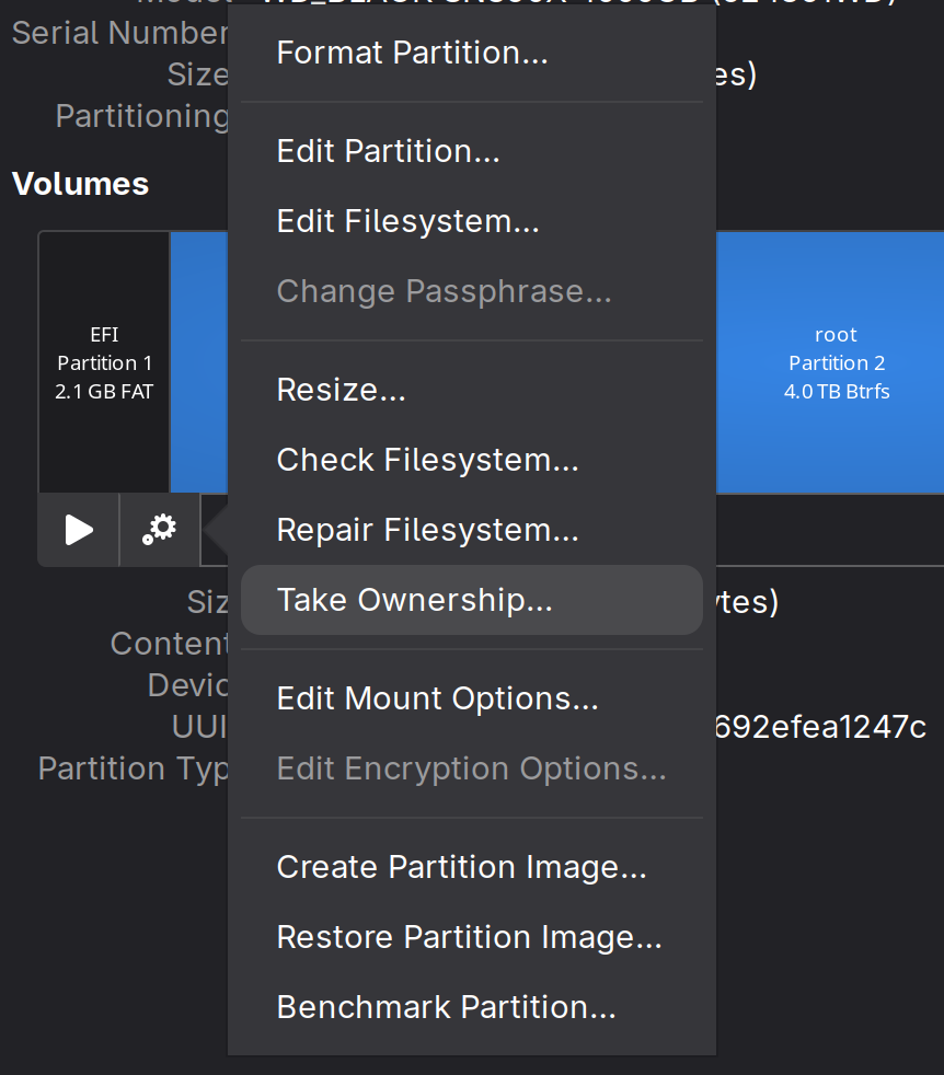

Use GNOME Disks (gnome-disk-utility) or whatever KDE’s equivalent is to “take ownership” of the partition. That should fix your issues.
