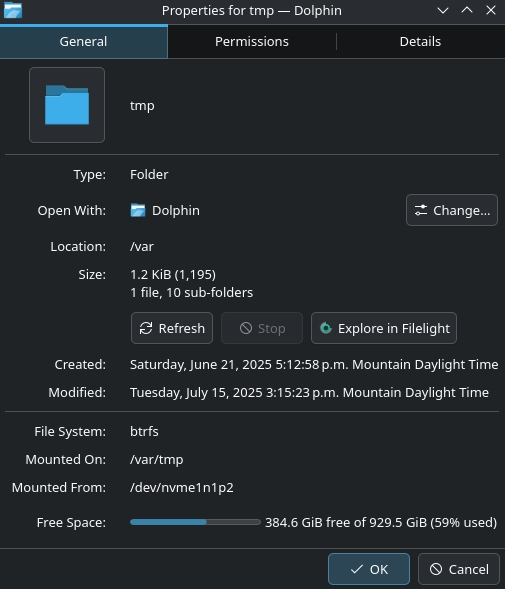

What filesystem is /var/tmp and do we have enough memory?
❯ nvidia-smi --query-gpu=memory.total --format=csv,noheader,nounits
8192
/var/tmp is located in my main drive for cachyos which is using a btrfs file system.
Ok .. I’m no expert in BTRFS .. but from my digging it appears that while it supports unnamed temporary files it is advisable to disable CoW (Copy on Write) for the directory they would be written into.
So I might suggest apply the following;
sudo chattr +C /var/tmp
References:
Done, will keep you up to date on whether it worked. Thank you for your help.

Hm.
Are we sure the property was applied?
Was the directory empty when chattr was applied? Because if not it may have failed.
