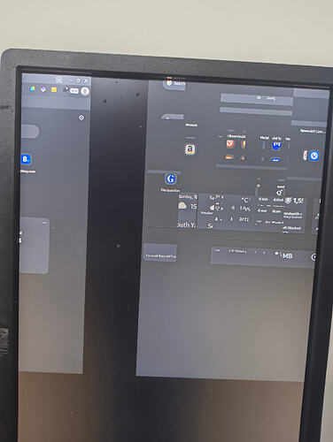

Dual monitor setup, left monitor is portrait and if I snap a chromium based app to the top so it goes full screen it stops drawing the window properly (see attached image). I have made some observations I will list below in case they help. Also here is the bug log b0b7ed7
  • This issue only happens when you snap to the top and it goes full screen and you have another chromium app open on the main screen.
  • It only happens to chromium based apps.
  • Minimising the chromium app on the main monitor stops the issue on the other monitor.
  • If the screen is rotated to landscape the issue no longer occurs.
  • Having another app in the foreground such as console stops the issue
  • Snapping Konsole to the left side of the main monitor stops the issue on the second monitor.
  • Snapping a chromium window in to any position other than full screen works fine.
  • If you use the shake to find feature on the problem monitor it displays correctly then when you stop it goes back to rendering incorrectly.
  • This machine is running an RX580 and did not have this issue when previously running with an RTX4070
I would be great-full for any information that might help me work this issue out.
