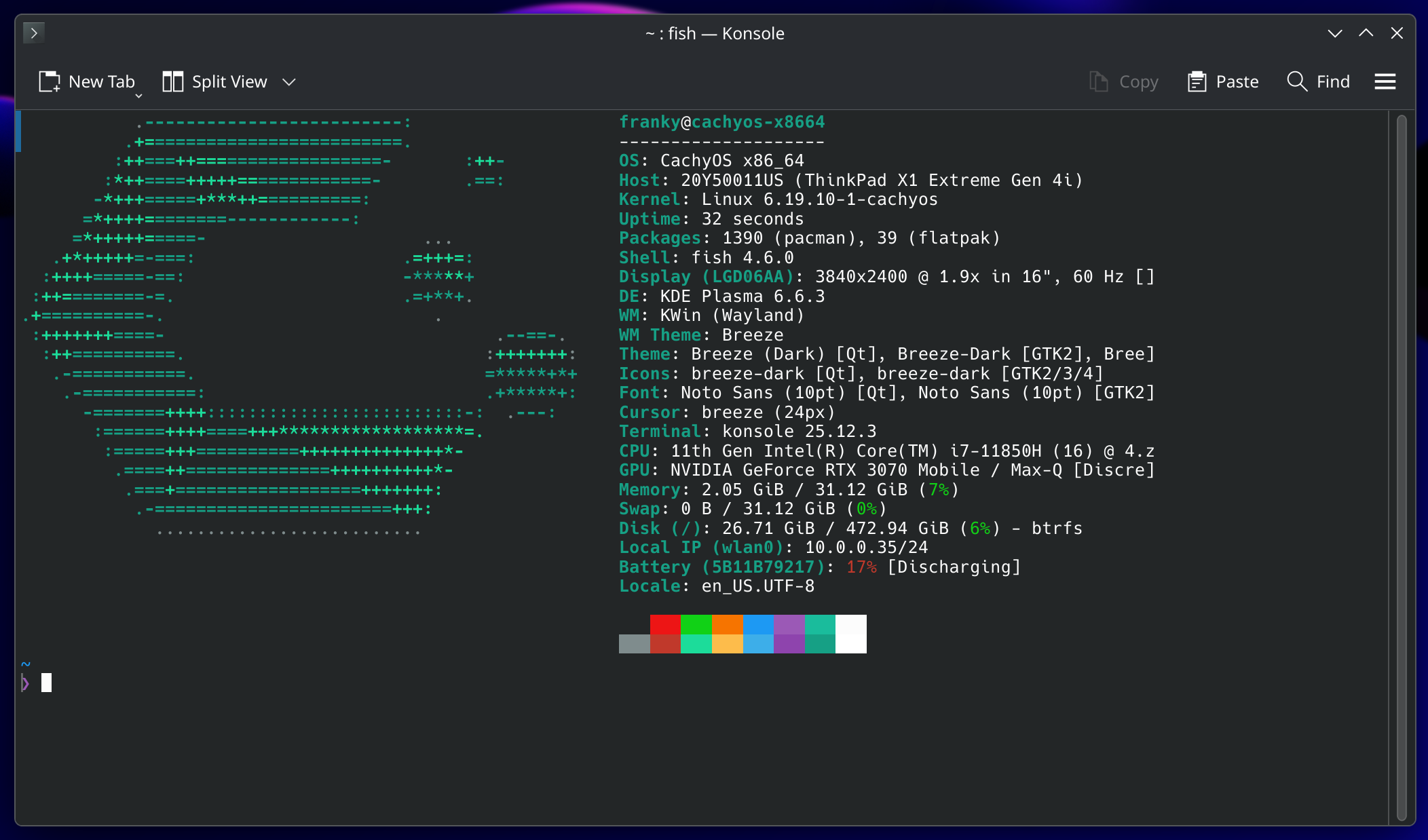

Screenshot of my setup in case its relevant.
Read the arch wiki on integrated graphic :
Hybrid graphics - ArchWiki .
Note that the monitor must be connected to the integrated card connector and the software will use the desired card. This can explain why you had to disable the integrated card to have the correct output.
